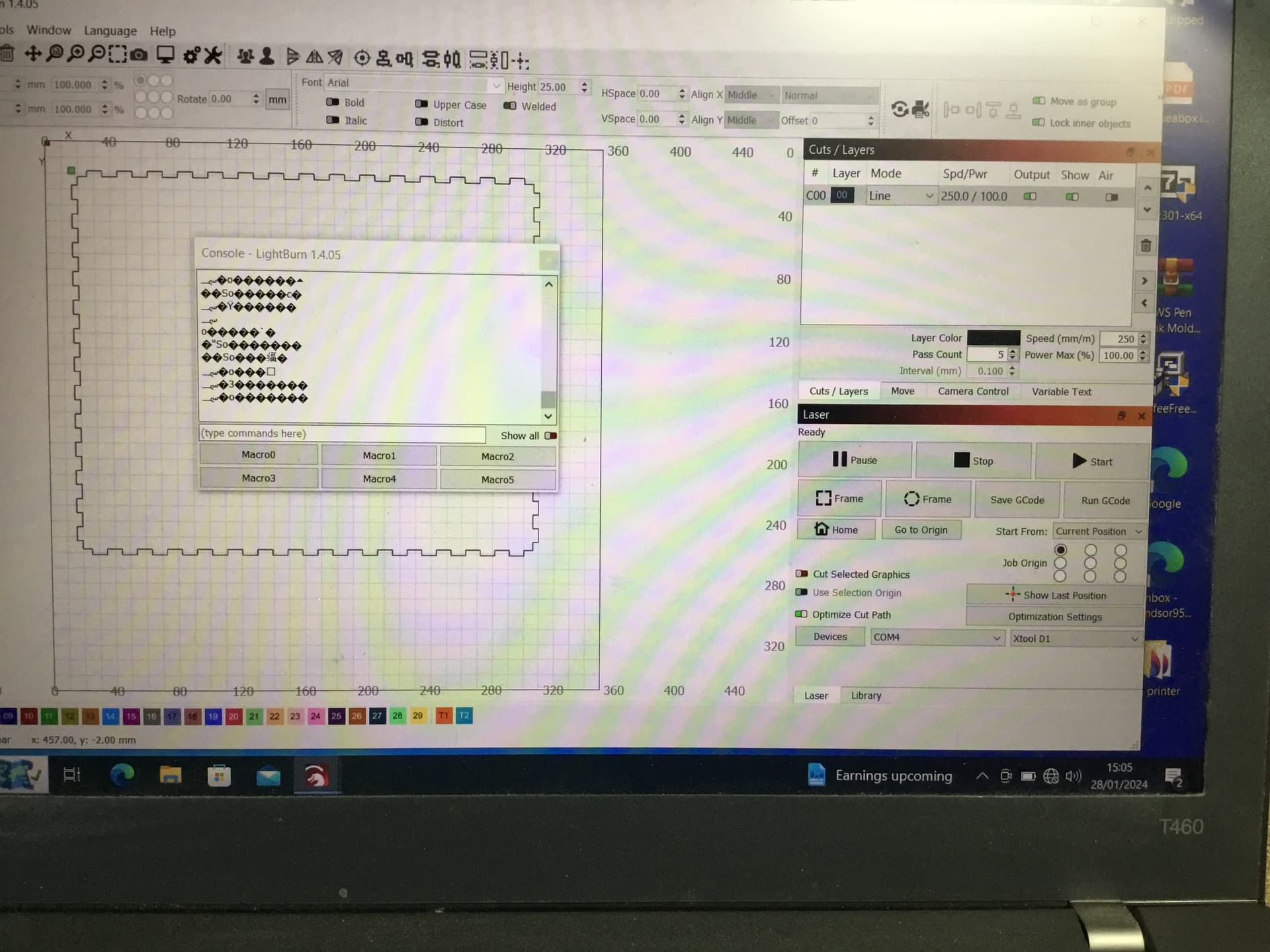

Make sure that the correct serial port is being selected for the laser in Laser window.
If that doesn’t work, take a full screenshot of LightBurn with Console and Laser windows in view.
Thanks for your reply.
The laser is on com 4 and is showing as “ready”

The image on the console panel is constantly scrolling up

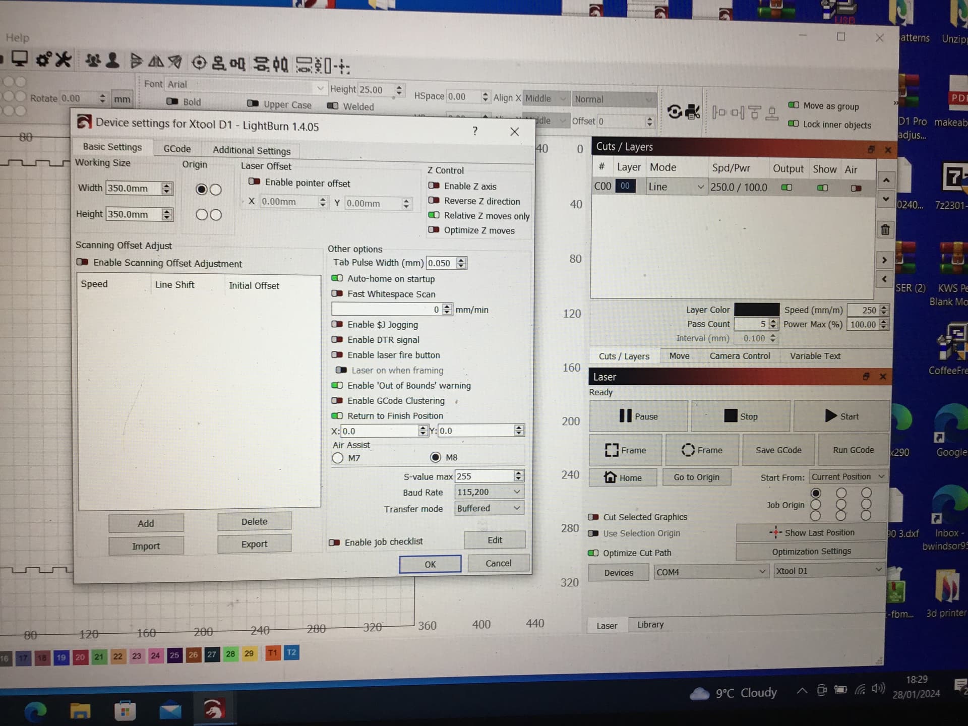

Are you certain that the COM port should be COM4?
Can you take a screenshot of Edit->Device Settings?
There’s something off about your device configuration.
Did you create the device using the .lbdev file provided by xTool?
If not, I suggest you recreate your device.
First, download the .lbdev file from xTool:
Operate xTool D1 Pro with LightBurn - xTool Support Center
Then push Devices button in Laser window. Select and delete the existing laser. Then push Import, then select the .lbdev file that you downloaded.
Once device creation is complete, test the function.
