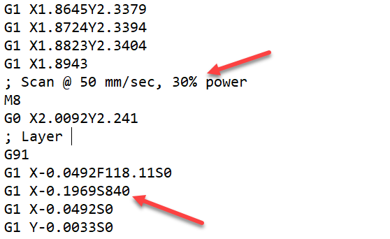

2023-04-10_12-21-59 96357 S2800
Please confirm the S-value max setting and the value assigned to $30 are the same. I have to admit, I’ve missed the ‘OK’ button once in a while.
The GCode sent by LightBurn is scaling the Spindle (laser) power on a scale of 1-2800. The engraver is expecting a number between 50 and 1000. The GRBL controller in the engraver will assign the bottom scale number (50) to spindle power commands under 50 and the top scale number (1000) to spindle power commands over 1000.
When LightBurn called for 100% of 2800 the command S2800 was issued. The controller will apply the maximum (S1000).
When LightBurn called for 60% of 2800 the command S1680 was issued. The controller will apply the maximum (S1000).
When LightBurn called for 30% of 2800 the command S840 was issued. The controller will apply S840 or 84% of 1000.
2023-04-10_12-21-59 96357 S840 30%
That’s why the test looked so consistently overcooked.
Good Test! Lots of data!
