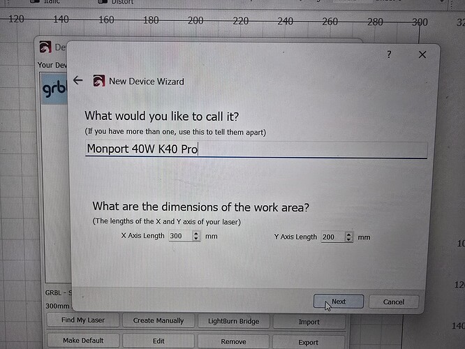

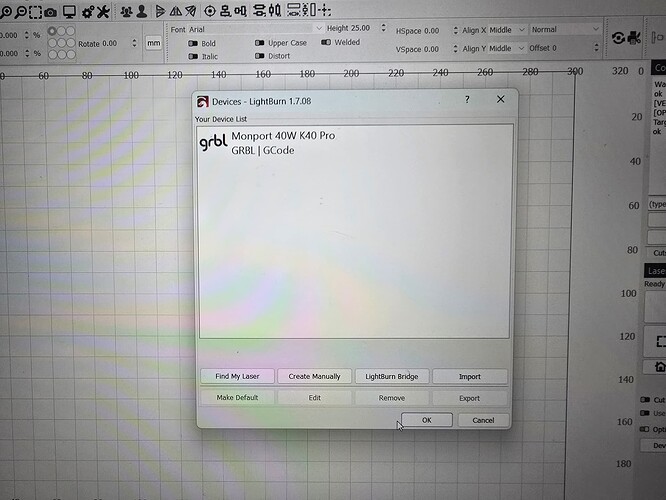

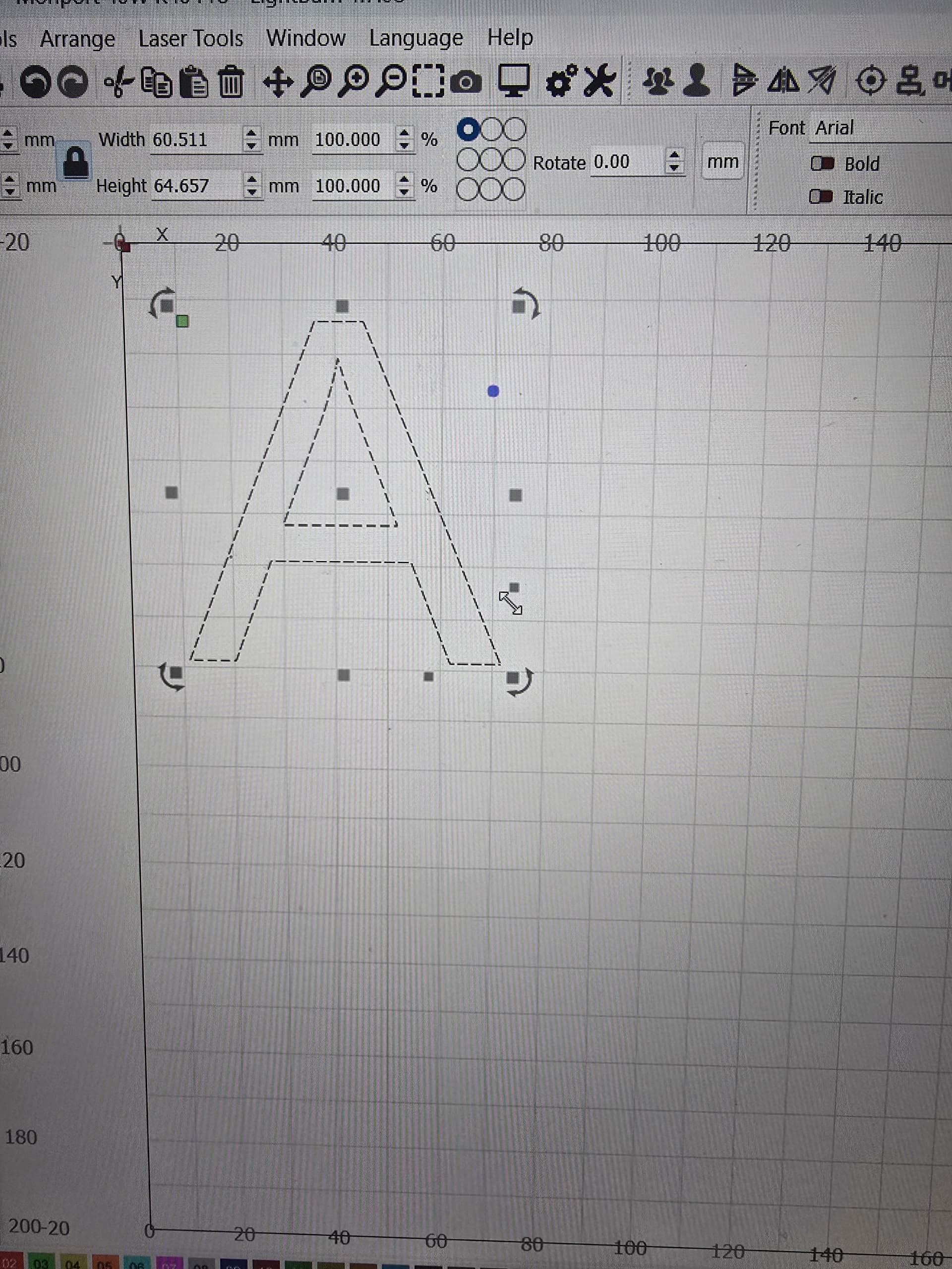

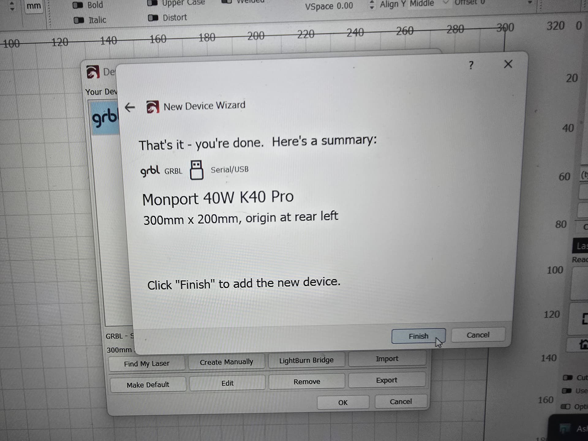

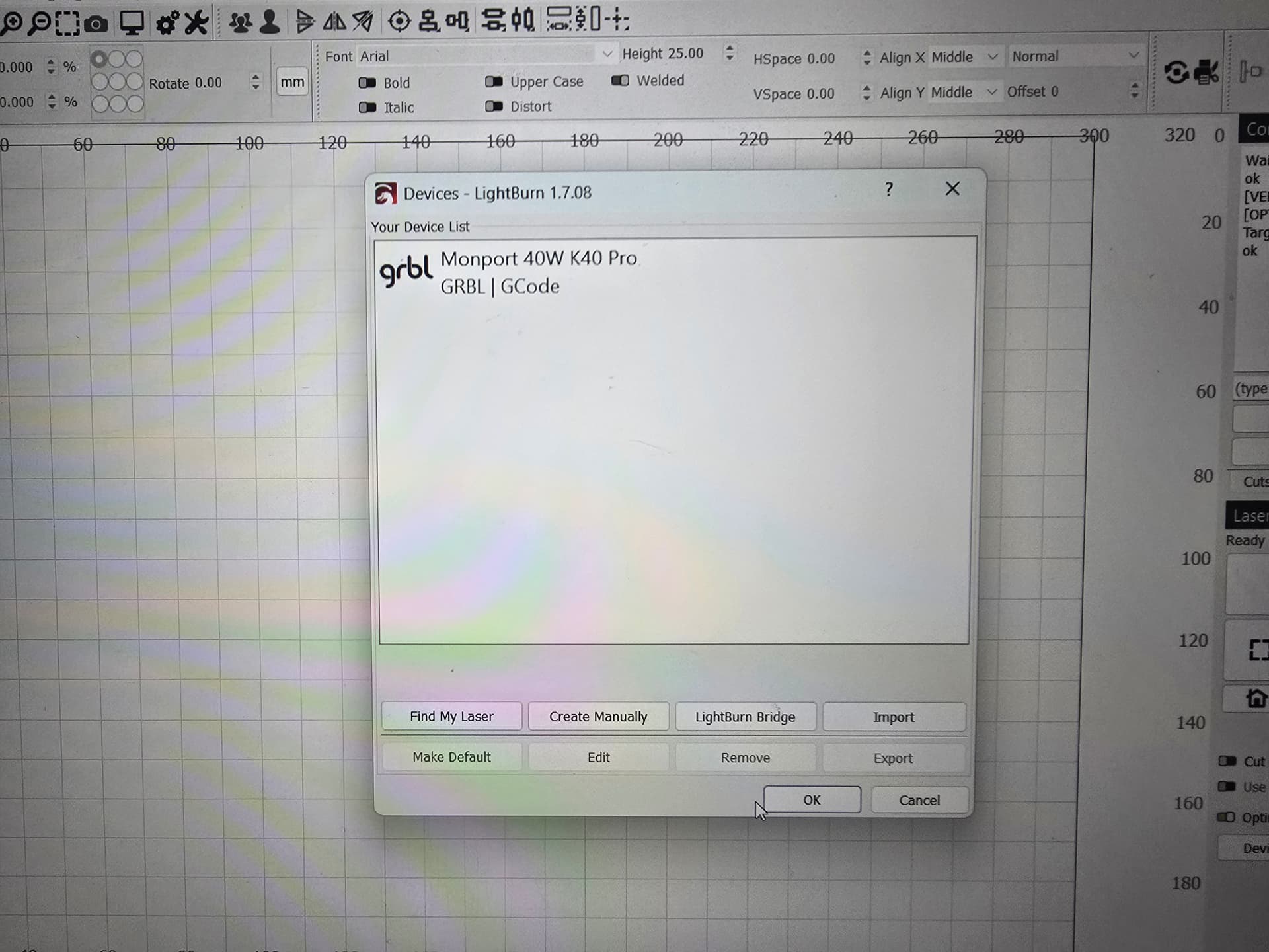

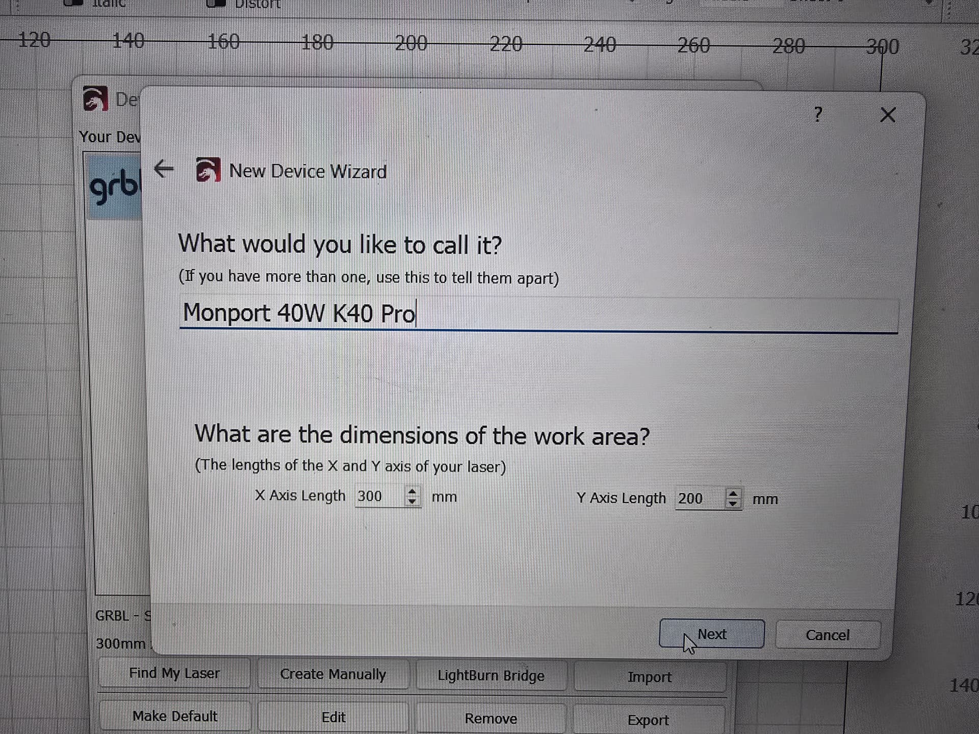

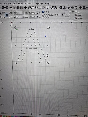

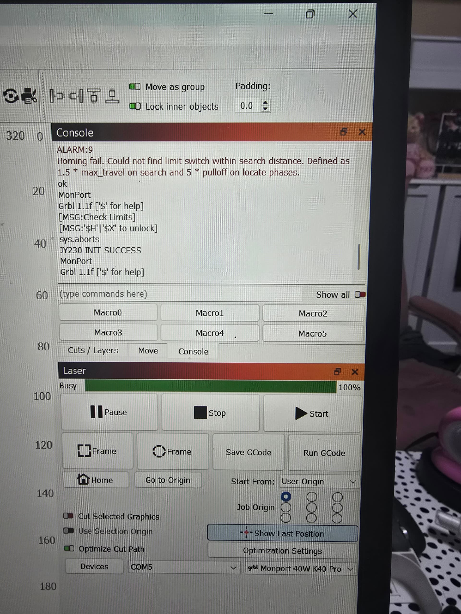

I just received my Monport k40 Pro Laser. Was super excited as I thought this would be an easy set up. I downloaded lightburn and started the process to initiate my first project. Well, the machine isnt framing properly. When i tried to cut my first project, the laser only went up and down rather than creating a square of wear it would cut. Thinking of sending it back, but I just want to make sure that I exhaust a few options.

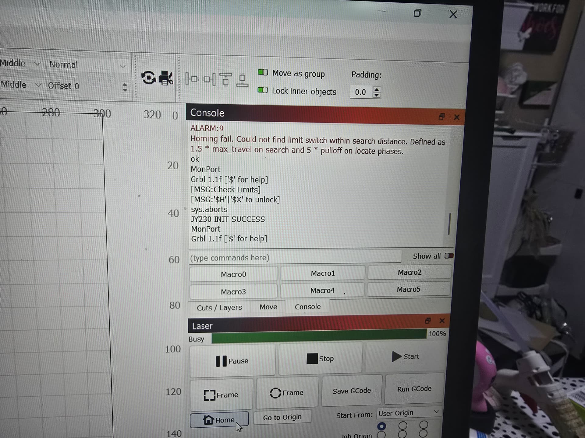

No, it doesnt home properly. Y-Axis will move up, but the X-Axis will not move the laser head over.

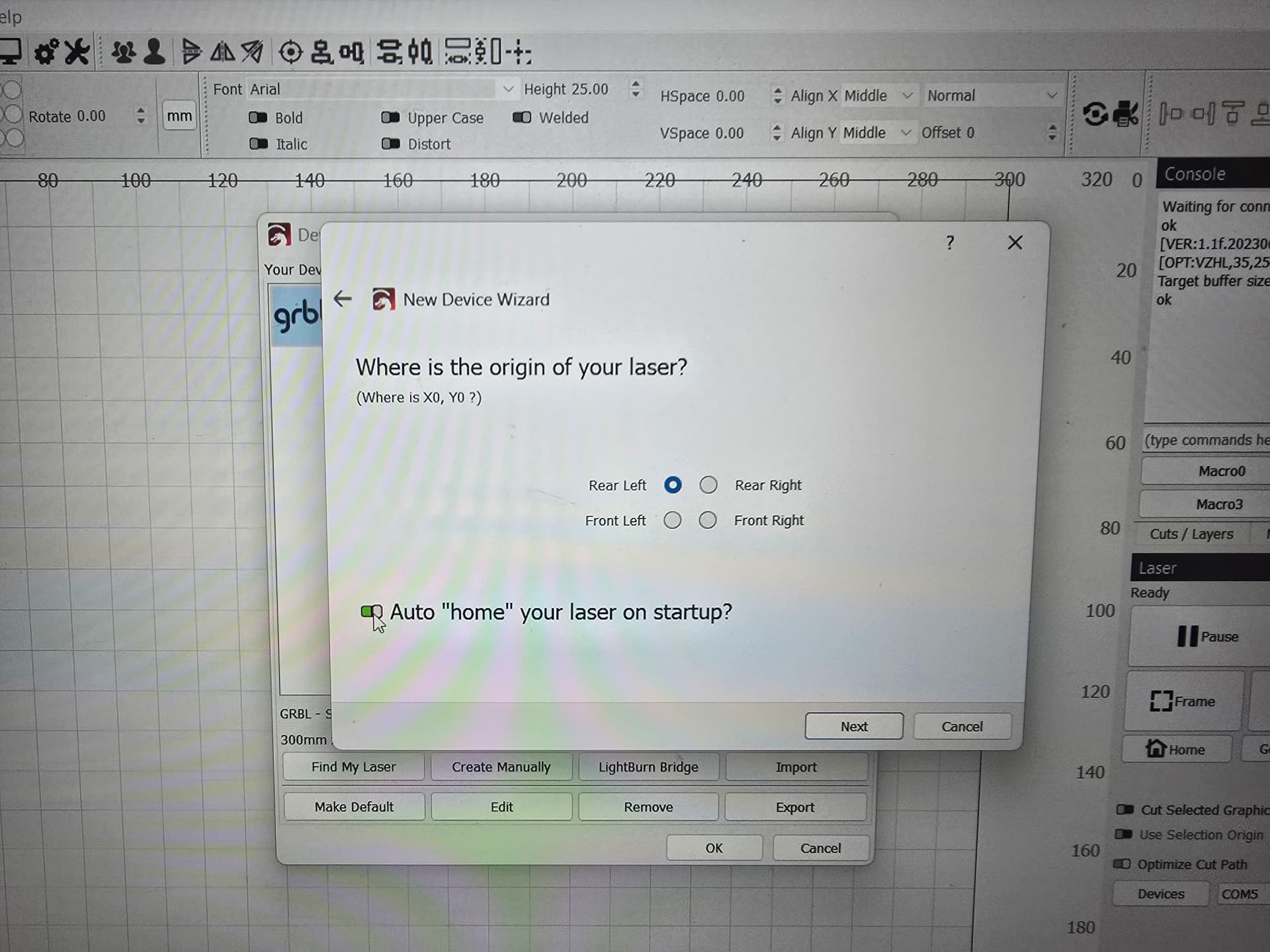

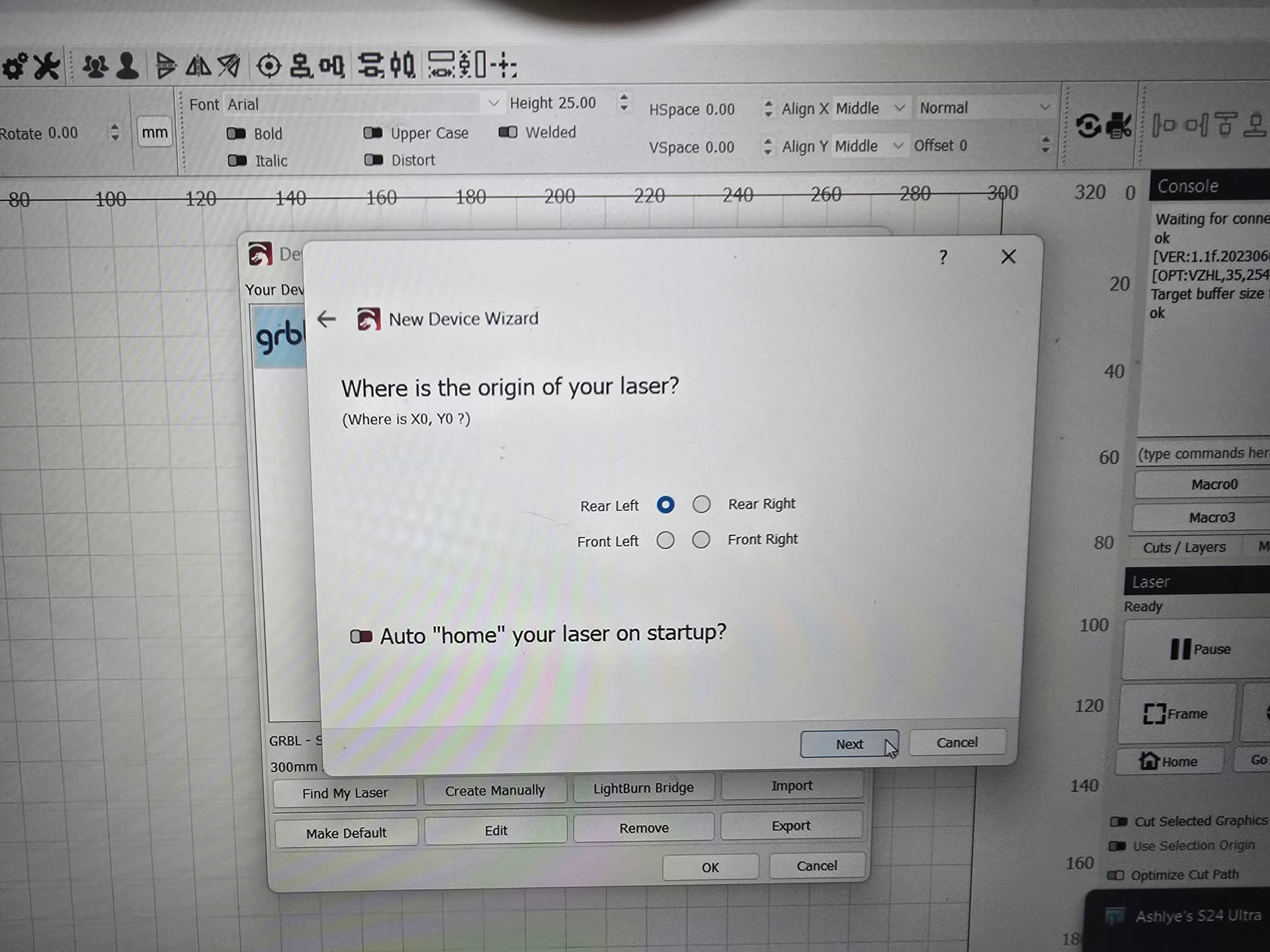

For some reason unable to load the videos. However, I had to remove the Auto Home Device so that I did not receive the Alarm 9 Error message. If I did not remove the Auto Home Device then the laserhead would not move at all.

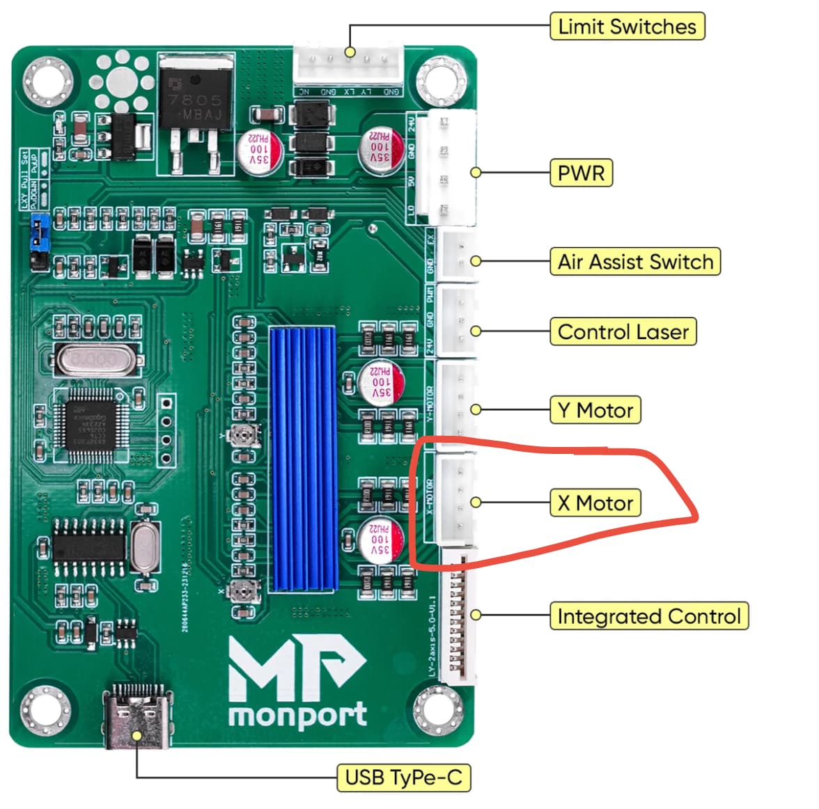

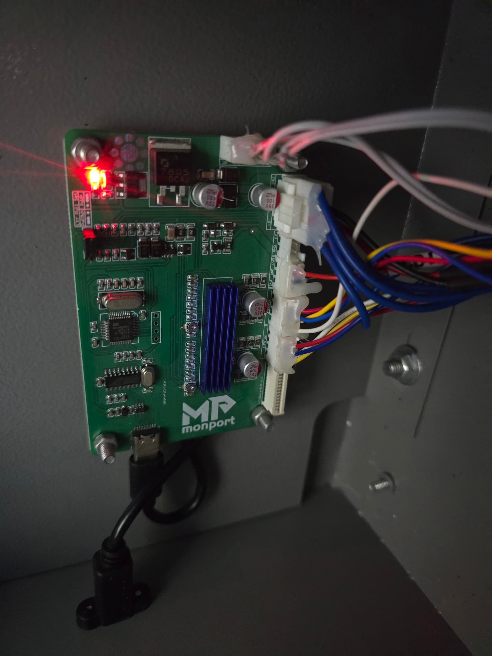

Is the X-axis motor plugged into the controller properly? (If the control board looks like this? ) Check all the connections - especially the connector here:

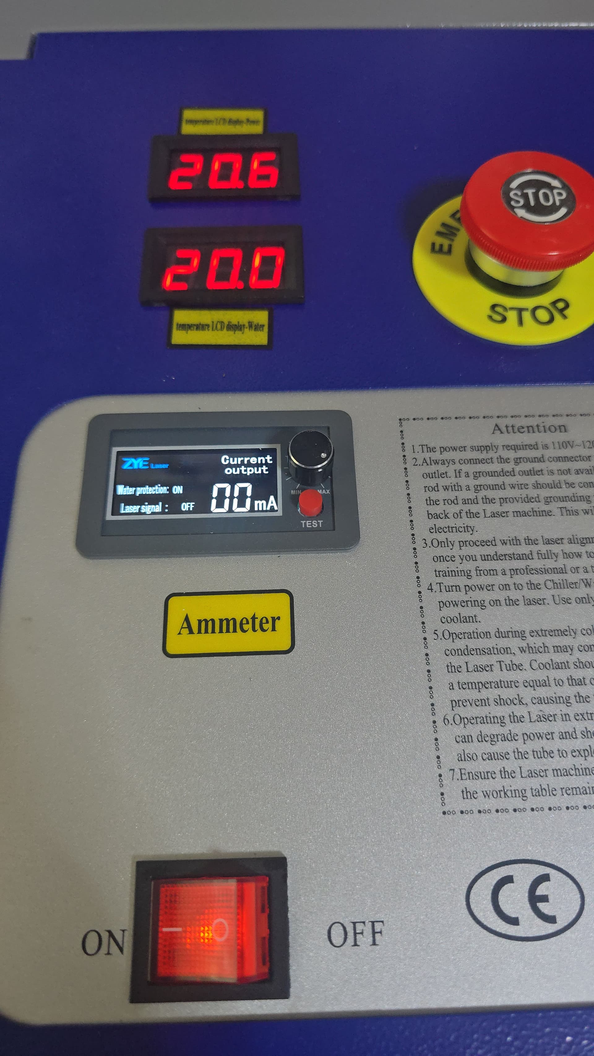

Here is a picture of the Monport K40 Pro configuration. From your picture. The Air Assist isnt connected. But I dont know if I am looking at this properly.
If you’re not getting left-right motion at the head that means one of the following:
  1. your controller has an issue with the driver
  2. your X motor has an issue
  3. your machine is somehow mechanically locked
Can you confirm that with the machine off, that you can freely move the laser head left and right? Repeat after machine is powered on. Are you still able to move head?
On the control board, make sure that the X-axis cabling is firmly seated into the controller. Do this with the machine off to prevent any potential shorts.
Yes, with the machine off, I can move the laser head side to side and up and down.
What happens with the machine on?
Did you review the wiring at the X-axis labeled portion of the controller?
