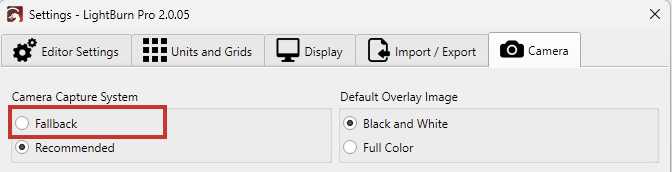

Hello everyone. I have a Monport Mega 70W and tried to see if I could connect the camera with this new version, but it still doesn’t work. The manufacturer is aware of the issue and clearly specifies it, saying that to see the camera correctly, you need to revert to version 1.7. The camera is detected by Lightburn, but it provides a “standard” image and a prompt prompting for configuration. However, it isn’t possible to do so. The Monport Mega uses custom grblHal firmware. I was hoping this version would fix the problem. But at this point, I think it’s more of a power supply issue or a firmware programming issue.

How is this camera even connected? (How does it show up in the Windows Device Manager, and can you use it with the Windows Camera app?)
Does it work when you use version 1.7 as they recommend?
You may need to change the Camera Capture System to “Fallback”
OK. I’ll try tomorrow and maybe I’ll take some screenshots for you.
Did changing the Capture System help, or is there another issue with the camera?
No. Changing the acquisition method doesn’t make any difference. I think it’s a firmware issue with the grblhal controller.
