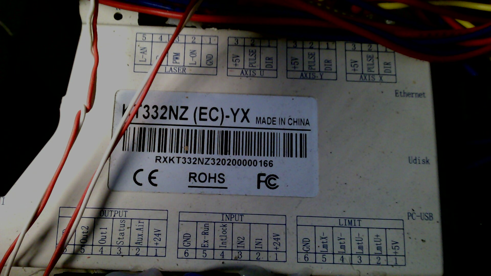

@ednisley has one of these controllers, maybe he can help you out. I have a 6442g and I’m not sure what to advise…
That Z suffix suggests a difference from my plain old KT332N (EC). A casual search for KT332NZ produces no results, so it’s either proprietary or the new hotness.
I think the N suffix means the network is enabled and the (EC) has something to do with the usual “China Export” mark elsewhere on the sticker, but that is guesswork based on hints.
The Machine Settings have entries for both U and Z axes, but the controller has only a U axis terminal block on the back that goes to the stepper driving the platform leadscrews. AFAICT, the Z axis settings have no effect on anything.
The machine panel has two buttons controlling the platform, both marked U, and shows the U axis in the display:
Does changing the Enable U Axis setting make any difference?
I think you have a different KT332N controller which will require intervention from the good folks at @LightBurn before it works properly.

Have you changed the Enable U Axis setting? It might make whatever is now Z become U (or the other way around), although I have no idea which value would apply.
Are the buttons on the machine display labeled U or Z? That might hint at what should be going on inside.
I’m using the Ethernet port and could, if I learned a lot more than I know now, eavesdrop on those packets. For now, it’s a mystery.
Amusingly, the only option I have is “Enable Z axis”, not “Enable U axis” :slight_smile:
