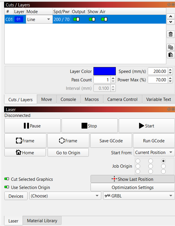

  7. Can you provide a screen capture (WinKey+SHFT+S) of your Lightburn grid area with the Cuts/Layers window showing?

Screenshot:

Everything you provided looks good. The only other thing I can guess is a safety interlock is keeping the laser from firing.
