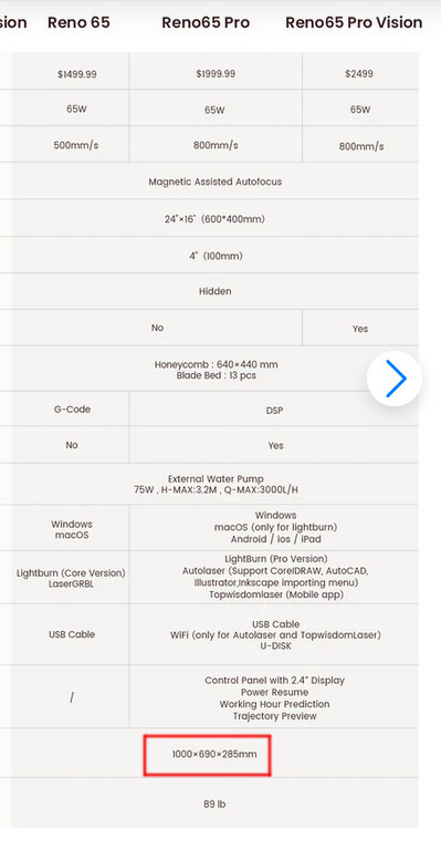

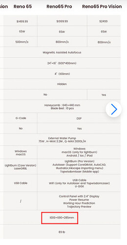

This is from the Monport site and the Reno 65 series. They state a 65W output. However. the width of the whole machine is only 1000mm as you can see in the advertisement. At the bottom.
I’ve been doing this for only about 5 years and am on tube number 3. I found a chart that estimates the output power of a tube based on length. The actual power is defined by the gas volume, but that’s difficult, so they generally just use the tube length. As you can see a 60W tube is 55mm in diameter an 1200mm in length… I seriously doubt they can shoehorn a 65W tube in a 1000mm cabinet. But you should check.
If you go to the site, they claim a 45W output in a machine only 800mm in width. I had an OMTech China Blue 50W. The tube was only 880mm and produced 43W… I doubt a tube 80mm shorter than my original will produce 45W. Just saying.

I also bought a Reno65 Pro (the original version), and I have doubts about whether the laser power can reach 65W. I asked Monport’s official technical support, and they replied that this is a specially customized laser tube. They also sent me a video of the laser power test and a data sheet of the laser power test. The maximum power can reach 68W, but they recommend keeping the power below 70% for daily use (which I am sure I know); I also have an industrial 60W CO2 machine, and compared to it, the power can indeed reach 60W
So if you need to replace it you’ll be paying big bucks for a customized tube… If you check for a replacement, what does it cost and how big is it. Not saying they can’t, but I don’t think it’s logical.
Simple enough to find the diameter and length of their tube… I bet you money, it’s a standard 50mm tube diameter.
I don’t know any vendor that is going to produce a tube for a special device.
What makes maximum power is the amount of gas within the tube. If the tube measures a certain size, then it’s output is limited by the gas volume.
I have a 50W, that’s it’s specified work power. I can push it, but it goes over the recommended specifications.
I think they are pissing on your leg and telling you it’s raining. If you can’t run the specified 65W all the time, it isn’t a 65W machine.
If you need 65W, you’d be rather naive to buy a 65W machine that you couldn’t use at 65W.
Limiting it to 70% of 65W gives you a tube/machine that’s really an operable 45W machine.
I really doubt, you’ll use that much power, depending on what you do.
