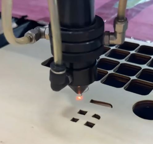

This is an almost stock machine, only the head mechanism has been changed. Stock air pump, exhaust fan and top completely open. In this short video, I’m cutting 5mm sub flooring 11mm/s@45% using a 43W tube.
Hope this helps, but I’m not sure exactly what you’re after.

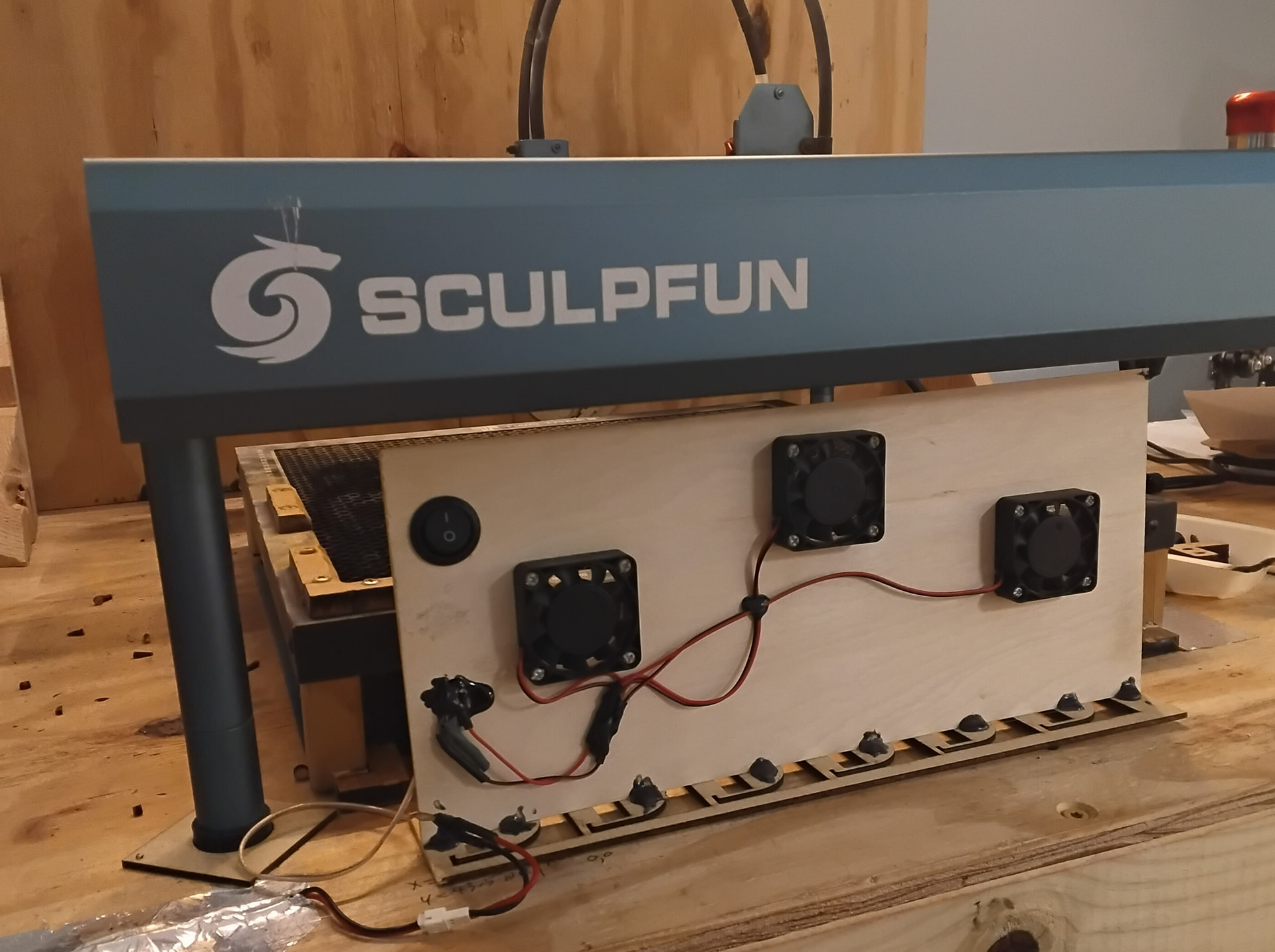

To help move the smoke away from the work, I have 3 each 1” fans at the front of the honeycomb.
I’m still waiting on OPs images, but @MikeyH is right and what a spoiler! I was going to say that extraction and extraction direction play as big a part as air assist in trying to keep the material clean.
