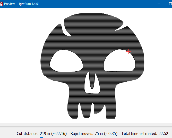

Currently I’m just using layers to designate an putter shape to engrave/fill (wood), while cutting a shape out of the middle (line), while using the corresponding power/speed for each. Currently the inner shape is cut out first, the the engraving happens. I suppose if that order were switched, it wouldn’t make a difference. But what i would like to do is save some time by engraving the main shape, minus the cut out. I was thinking there was a way to do this with trying to mess with the offset fill. They are odd shapes, not just a circle in a circle. One is a skull shape, cutting out the eyes and mouth.

I am leaning toward Boolean weld command. You want to cookie cutter the inside of your object so you can skip over the part that is inside the eyes?
that is correct

Is this what you want to achieve? Blue layer was moved to FILL to be easier to see.
Select skull
UNgroup the skull/eyes/nose
Select eyes and nose (red layer)
CTRL+D to duplicate shapes, then select blue (one red and one blue)
Preview shows eyes and nose are not filled
I need the eyes physically cut out of the shape. On the file I have 3 layers. Blue is the final cut, cutting the shape from the board. Green is fill to burn/engrave. And red is the minor cut to cut secondary shapes from the primary ones.
So on the circular objects: the skull needs to be burned, and the eyes and mouth cut. My current setup will do that.
I see what you did, and I could do that. I was just wondering if I could do it more efficiently; some setting to show a layer like an overlay or something.
