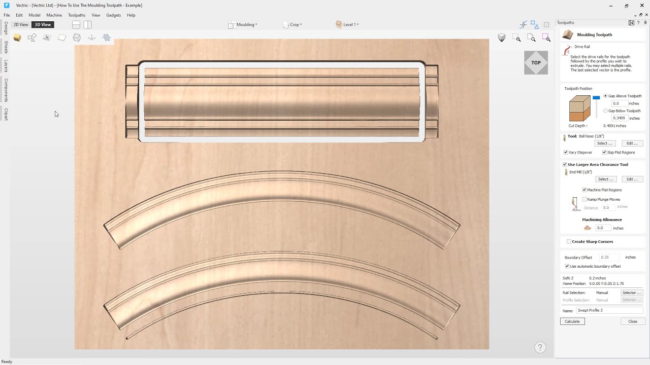

In Vectric VCarve there is a Moulding Toolpath which allows you to extrude a profile along a drive rail to create mouldings, frames, and decorative profiles without full 3D modeling.
Is there any plan to introduce a similar toolpath in MillMage?
This feature is extremely useful for producing trim, picture frames, raised panels, and other continuous profile shapes efficiently.
