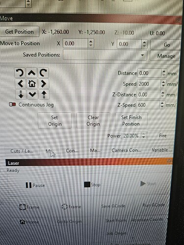

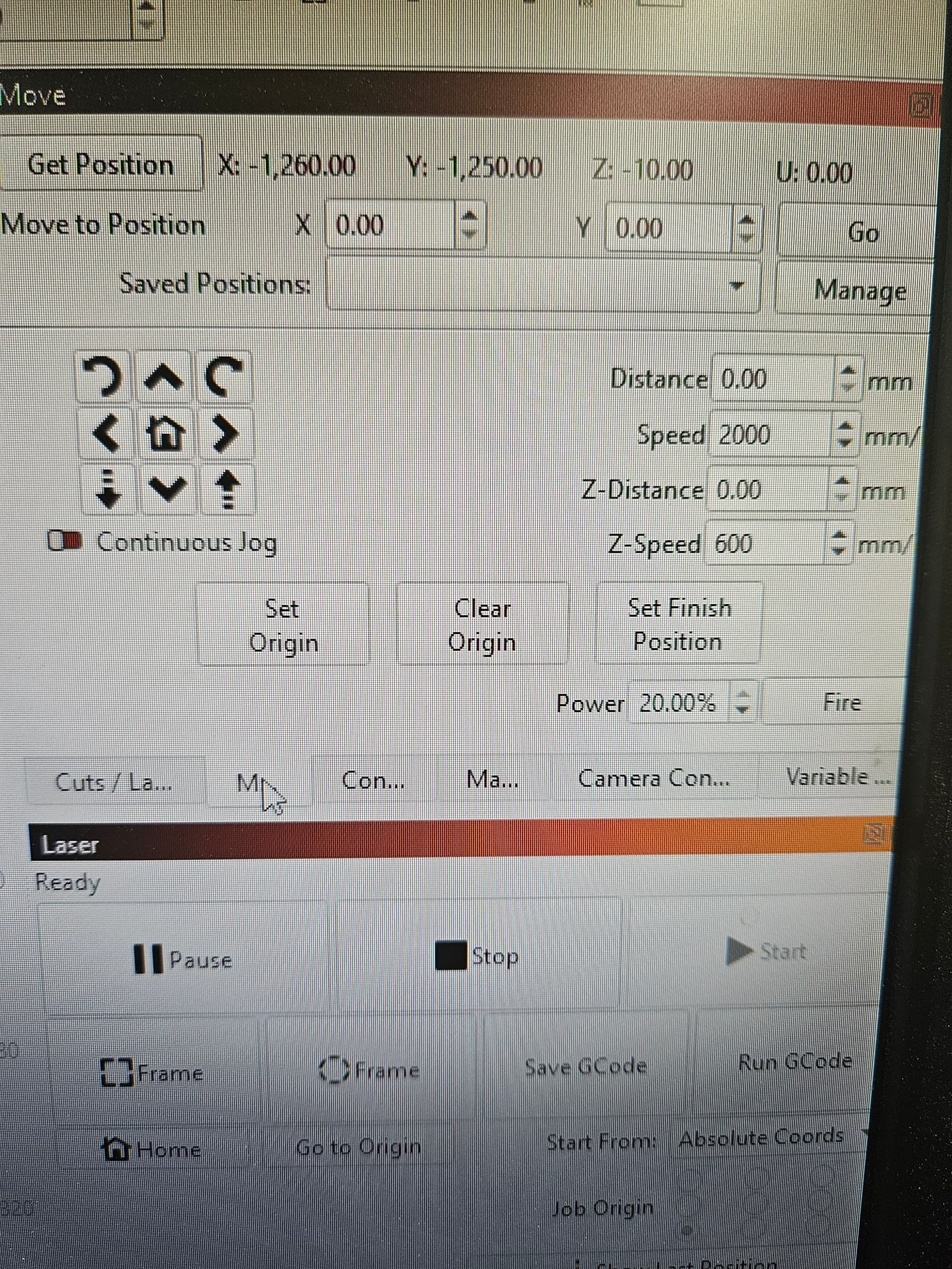

Here is what i have in the Move windows:
Something is really wonky here.
Differences between offset and reported position:
X 27
y 127
Z 34
Do this so we can see what might be happening…

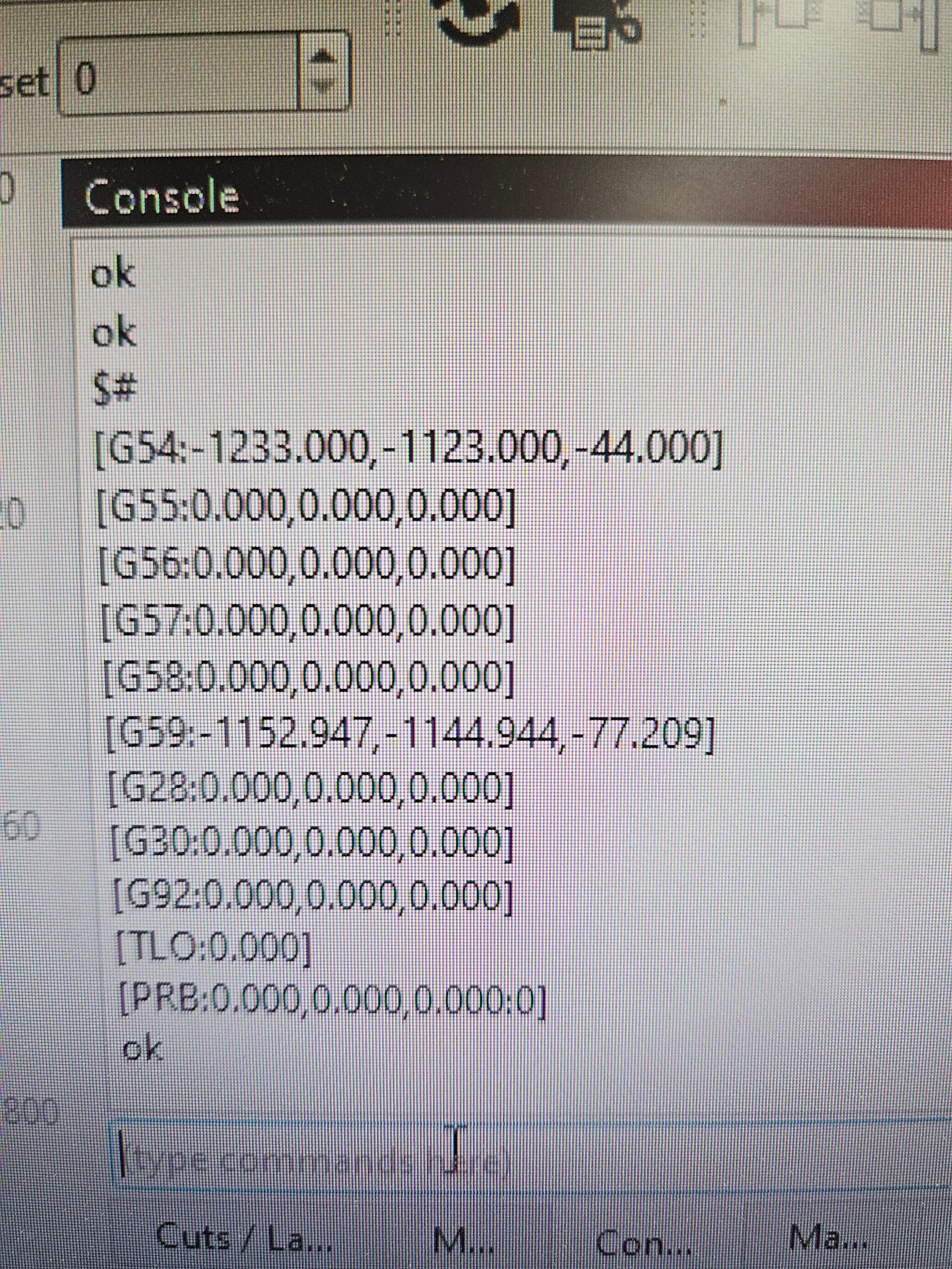

  1. Enter $$ in the Console window.
  2. Enter $# next
  3. Enter $I (eye) next.
  4. Enter ? next.
  5. Enter $G next.
    Copy everything starting with the $$ and below, and paste it in a reply.
In the Machine Settings window, click on Save to File. This is your safety net.
Once we get the original settings documented, I would like to make some changes to the parameters to see if we can get them making sense.
By the way, camera pix of the screen suck because of the interference patterns. Please use the Windows Snippet Tool ( Windows key + Shift + S).

This computer has no internet, as it is in the cottage. That is why i had to take screenshots with the phone
Here are the settings

[G54:-1233.000,-1123.000,-44.000]

My understanding is that off sets defined when doing a $# are offsets from the machine zero?
So I’m my instance I get a g28 in the list of offsets that is g28:-417.000,-427.000,-3.000
This is the offset from the top right corner to the home switches with a 3mm offset from the switches.
If I want my g54 0,0 to be the same as the g28 home position then the offset in the table for this should read the same.
