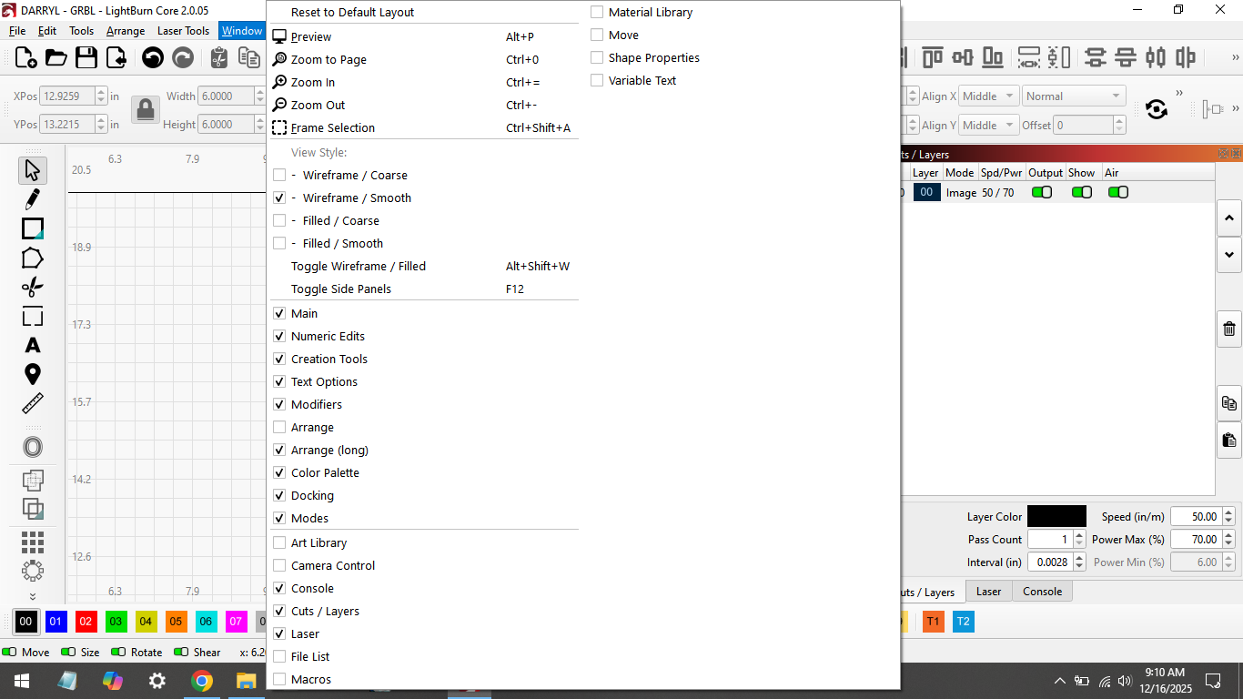

I just upgraded my software and now the move button is gone form the windows choices. Please help.
Either check the Beginner Mode switch, or
WinKey + UpArrow to maximize the Lightburn window.
Thank you for the reply but that didn’t work.
It only goes as far as the macros selection.

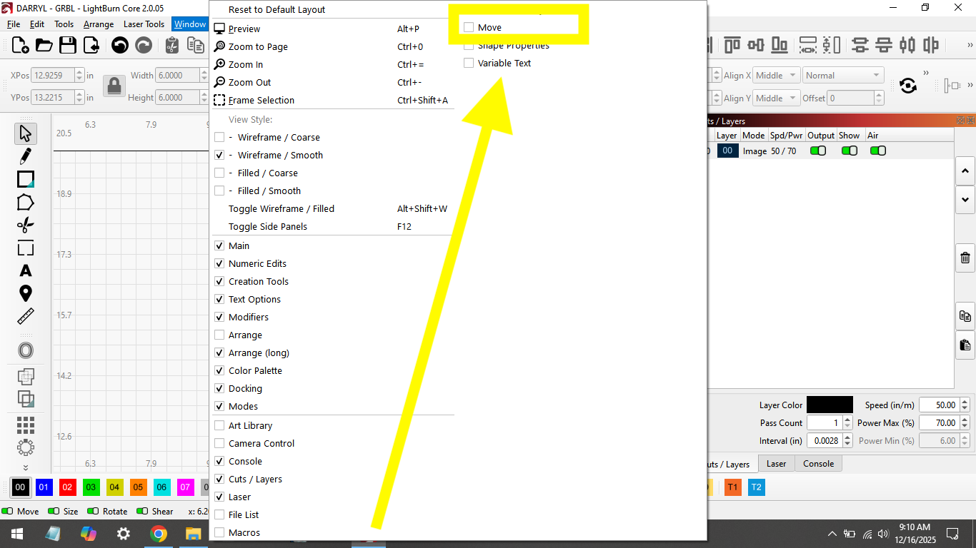

Because of the resolutioon / scaling of your display, the menu is too long and wraps to a new column. Follow the arrow.
WOW, , Thank you very much.
