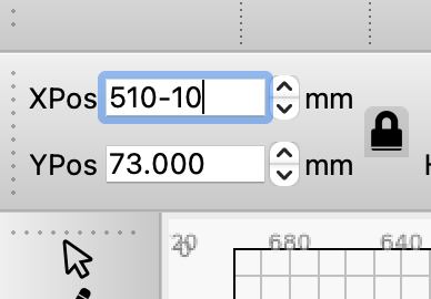

An example to clarify. Lets say I place a sheet material in the top left of the laser bed with the sheet top left corner at the top- and rightmost physical point the laser can reach. That point is currently represented as 510,0 in LightBurn. If I then want to laser a dot 10 mm in from that corner I currently enter 500,10. What I wish for instead is to in LightBurn see 0,0 at that top left corner and to place a dot 10 mm in I would set 10,10.

Using your example, in the X pos dialog type 510-10 then hit enter or tab out to another location and Lightburn will place it at 500 for you.

Without going into home positions or making this complicated, if you simply want to place materials in the top left. set the start from position to top left and use a user origin.
Set your origin after homing the machine to the top left.
See here:
Coordinates and Job Origin - LightBurn Documentation
Only time I use absolute coordinates is making templates. Start from is usually set to user origin on my software and machine. Then I can put it anywhere I want.
This exactly, thank you.
