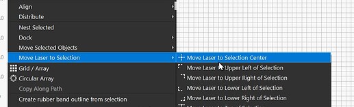

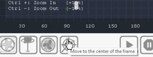

Move the laser to the center of the frame
Wouldn’t be easier to add a button to move the laser to the center of the frame in either the Laser or Move dialog box instead of hiding it in the Arrange drop down menu?
Yes, I do know about the Center Finder in the Laser Tools menu but it’s so cumbersome.

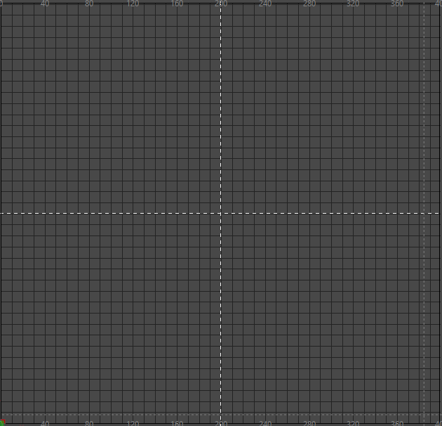

there is already a method for this:
Turn on crosshair
Click this icon
And click in the middle of the screen.

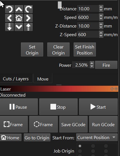

You can also make a waypoint under the MOVE window - I would be happy to show you how to do that. The instructions in the LB documentation are really world class, worth reviewing.
This computer does not have a machine attached - but this is the “MOVE” window. Enter your heart’s desire into the green highlighted boxes.
Select the destination from the drop down box and press the red highlighted button.
Note also you can Set Origin and Set Finish Position - should you desire, you can have the laser position itself at dead center after every job is run - saving you from having to press any more buttons.

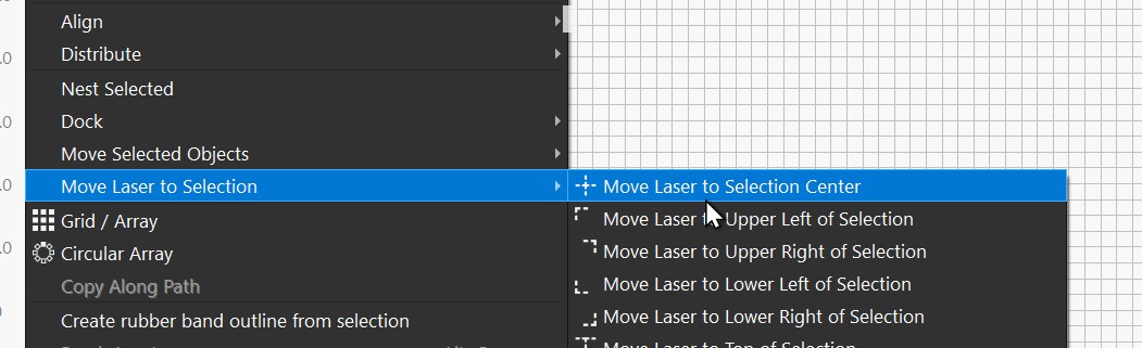

I think we already have this feature and have had it for a long time. Click on the last icon in the “Arrange” menu and a drop-down menu will pop up.
As I said, it would a lot simpler, there’s plenty of space next to the two framing buttons
Even more cumbersome then just pushing a button.
LaserGBRL has this feature and it’s so simple to use.

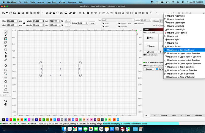

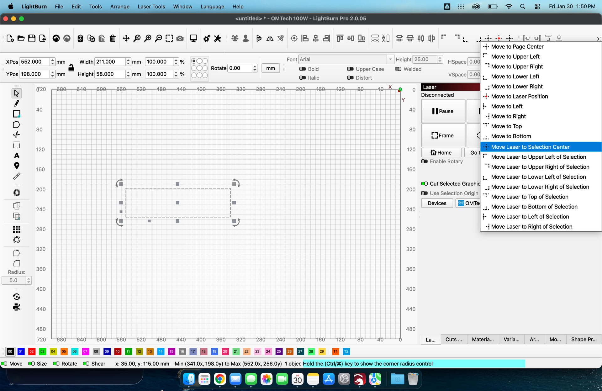

That button is available with 2 mouse clicks as pointed out by Bernd. Click the dropdown arrow at the right of the move selection, then click your choice.

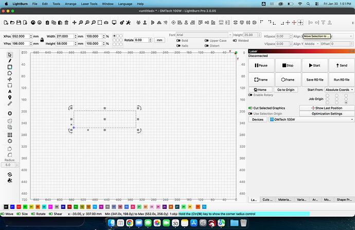

Looking at my screenshots, where would you add another button? My docking tool bar is already truncated.

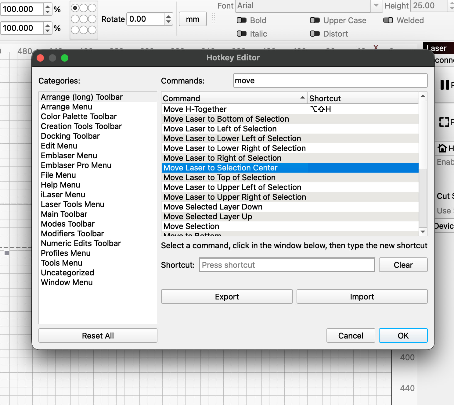

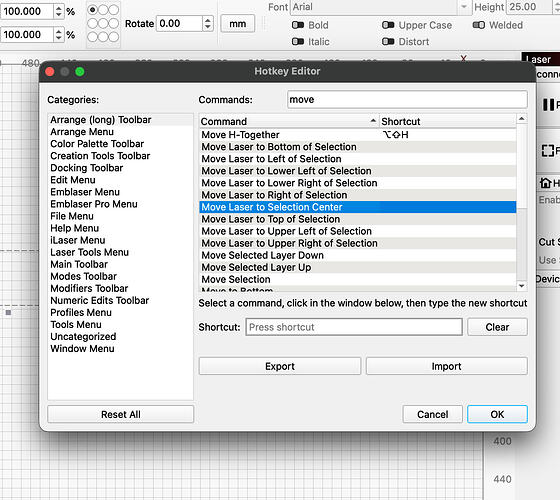

If this is a feature you frequently use and 2 clicks is not acceptable, create a hotkey for it.
  1. To the left of Set Origin or
  2. To the right of Set Finish or
  3. Change both Save GCode and Run GCode to 2 lines, Condense the circular Frame button then you’ll have room for either the GPS button that’s under the A (text button) or a whole new button or
  4. To the right on the Fire button
I’ve been looking how to do that since day 1, I’ve been searching for “Shortcut Key” :grinning_face: I’ve created one now. Thank You Tim.
The reason I posted here was I wanted to open a conversation in hopes that some new things would come to light (as in Hotkeys = Shortcut Keys) If I just posted in the Feature Request area, I’d still be looking how to do it.
