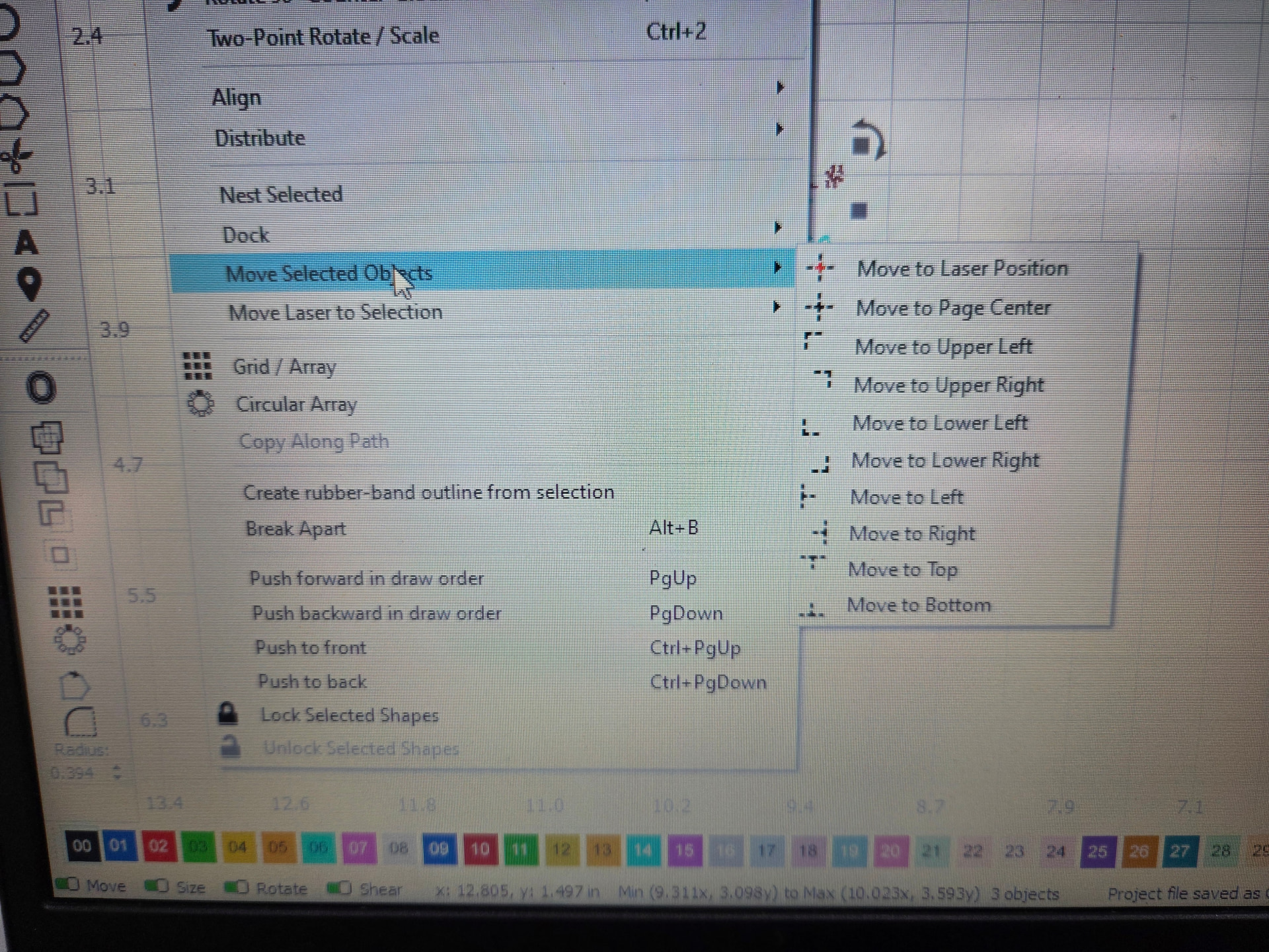

I have a new Boss Laser FM Station machine with Lightburn version 2.1.04 installed. I can’t find the Move to Laser Position Icon. It is there on my LS machine running version 1.7.08. Without this feature I can’t position images/text/arrays in the exact location for marking. The manual for the FM machine, available from the Boss Laser site for download, has illustrations that do not match what is actually running on the PC making it nearly worthless.

This is the command I can’t find: Move selected objects to Laser position…

Just to reiterate @NicholasL answer and bring this together: Move Selected Objects to Laser Position isn’t available for Galvo devices.
That tool relies on the reported XY position of a gantry laser head. Galvos instead use Absolute Coordinates, with positioning/alignment handled through the workspace and framing system.

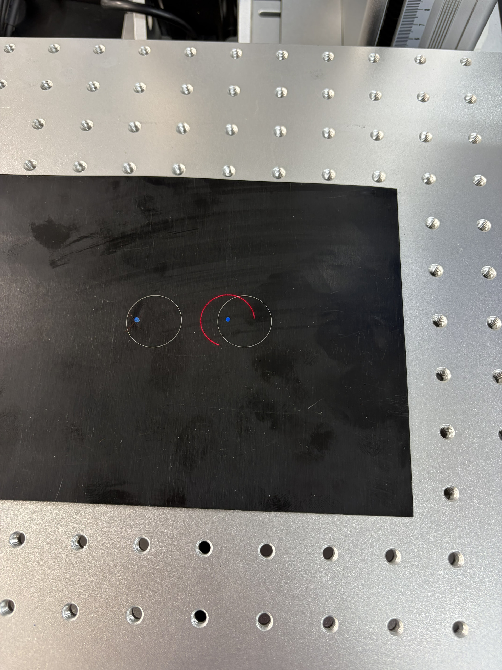

The problem I’m trying to solve is that the laser is not marking my text/shapes/arrays centered about the red dot. Have a look at the attachment (ignore the circle and blue dot on the left), you will see a blue dot that was used to center up the work piece with the lasers red dot. You will see a portion of the trace that is centered about the blue dot. I would expect the marking of the circle to be centered about the blue dot but it is not. As you can see the circle is marked about 8mm to the right.
Any Ideas why this is happening?
Thank you for any help you can provide.

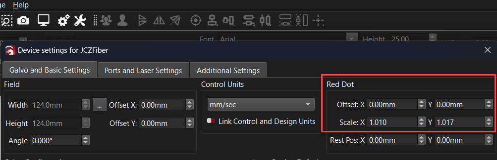

It sounds like your red dot framing is not aligned?
Try adjusting ‘Offset X’ in the Red Dot settings:
Laser Tools>Device Settings>Galvo and Basic Settings>Red Dot
Thanks for confirming what we thought could be the problem Nicholas.
From the factory the numbers were 8.25mm (X) and 0.80 (Y).
First I tried making it 0.00mm (X) and 0.00 (Y) but it didn’t help. Then I put 8.25mm (X) and 0.00 (Y) in the Rest Positions. This change has positioned all my marking centered about the red dot.
What are these Red Dot parameters for?
Presumably, the physical source position of the red dot laser will be slightly different (out of line) to where the fiber laser is coming from, so these parameters allow correction to ensure the galvos will still place the red dot framing in line with the fiber laser output.
The rest position only affects the position the red dot laser is when it is at rest (not framing). If you are using the at-rest red dot position for alignment (sorry I didn’t click that you were doing this), then I guess it makes sense that you would need to make an adjustment there also.
