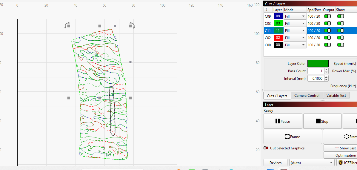

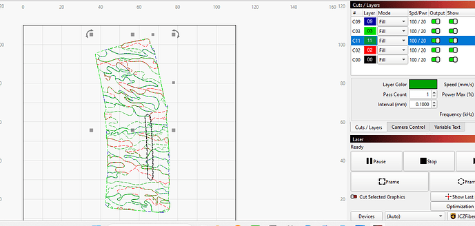

I finally got my camo design to where I wanted it, all camo sections were filled and the window wasn’t. I used a thumb drive to move the file from my desktop to my laptop and all the filled areas disappeared. The modes in the cuts/layers pallet still say ‘FILL’, but they’re not.
I just noticed something; the preview in the thumb drive doesn’t show the filled sections, either. Do they not transfer with the file? Just the outlines transfer? Is there some box I should have checked?
How do I get things back to where they were?

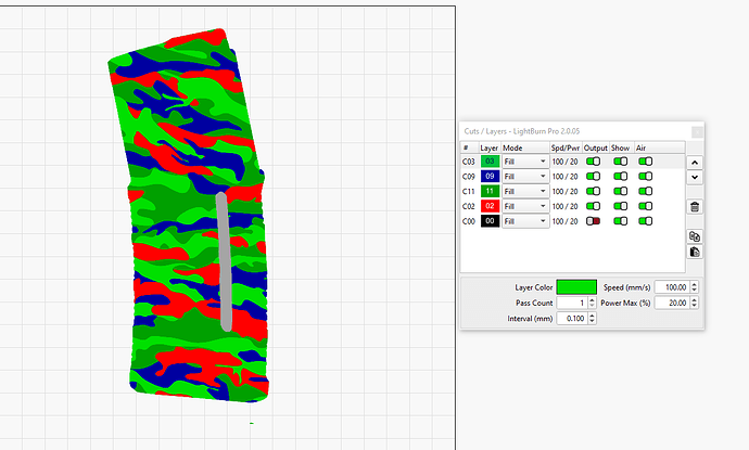

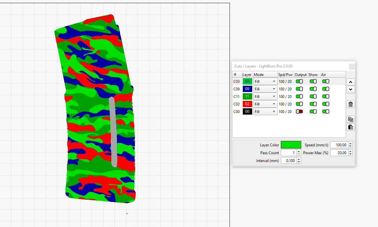

Here’s the same file on the desktop.

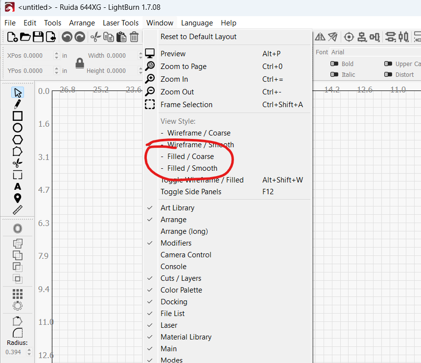

Check this setting on both computers.
In the Window tab
That worked, thanks. I clicked ‘toggle wire frame’ and the fill colors showed up.
I ran a test piece and it filled the camo over the window. I thought if I turned off the Output for that layer, the camo would skip over it, but it didn’t.
How do I get it to skip over the window?
Is the window on it’s layer? Group the camo layers and use the boolean tool for the window cutout.
Alright, I’ll give it a try. Thanks. That Boolean has always mystified me.
