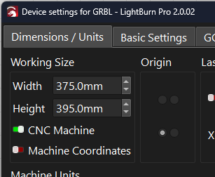

What are your current device settings for working size and origin in this area?, something like this?

After you home the machine, if you jog left by 10mm does it move to the right?
If so, toggle the ‘CNC Machine’ setting to invert the direction.

My ‘Device Settings’ are like your snapshot except my CNC Machine is disabled. I am running 2.0.02 and when I ‘Home’ and then attempt to jog left 10mm it moves to the upper right.
Then I installed the Pre-Released version 2.0.03-RC-3, you suggested, when it asked to transfer my settings to the pre-release version, I selected ‘Yes’. Well it is now “Jogging” as expected, hopefully this solves the problem for good! I did try the 2.0.02 version again and it still goes to the upper right. Thanks for your time and all the help, it is greatly appreciated!
