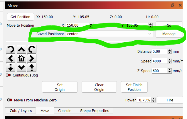

I want to set up one of the Macro’s so I can move the laser and gantry back and out of the way when I am done. Is there a way to do that?

You could do a macro that would do
G0 X400 Y400
This would move the laser head to the TOP right corner (if your machine is 400mmx400mm
G0 X0 Y0
Brings it to Home position
Unsure if you need something more specific?
EDIT As an afterthought
IF you want machine to ALWAYS do this after the end of a job, you could use the END GCODE
section on Edit → device setting > Gcode tab
This code will always execute at the end of a job
might be anoying though if you only want this done SOmetimes

In the move window you can also use “saved positions”
Move to the position you want and save position in manage.

I use set finish position.
Device Settings, Return to Finish Position.
Autohome Enable
