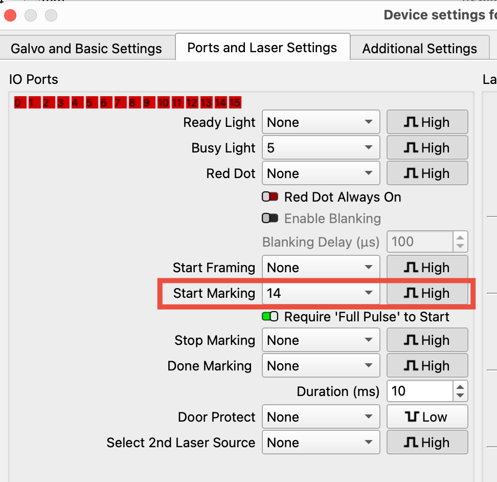

That workflow should still work fine, using the “Start Marking” IO signal for (1,2) and (4,5)
The ‘Done Marking’ signal could trigger (3) and (6)

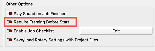

And you may have to disable “Require Framing..”;
