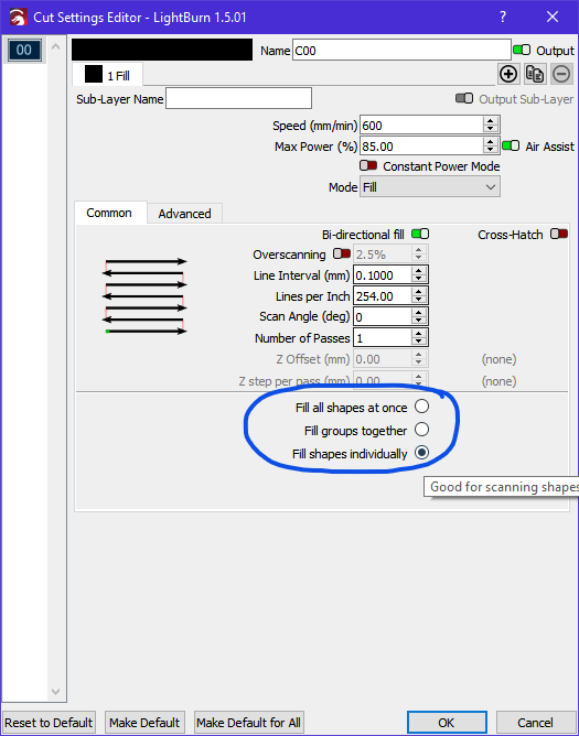

I’m watching my laser work on two items that are in the same layer. Unfortunately, they are far apart so the laser head is spending most of its time moving than engraving.
Would the best approach be to assign these two items to different layers, or is there a way in LB to tell it to complete each item, within a lyer, before moving on to the next?
So far I have created layers for each kind of laser-power/speed and not considered head movement.
