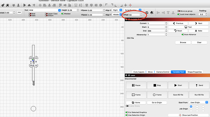

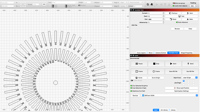

I am having a slight issue when I am trying to make variable text continue the serial numbers when i have 2 sets of circular arrays.
I’m looking to have 1 circular array on the inside and one on the outside, closer to the circle itself.

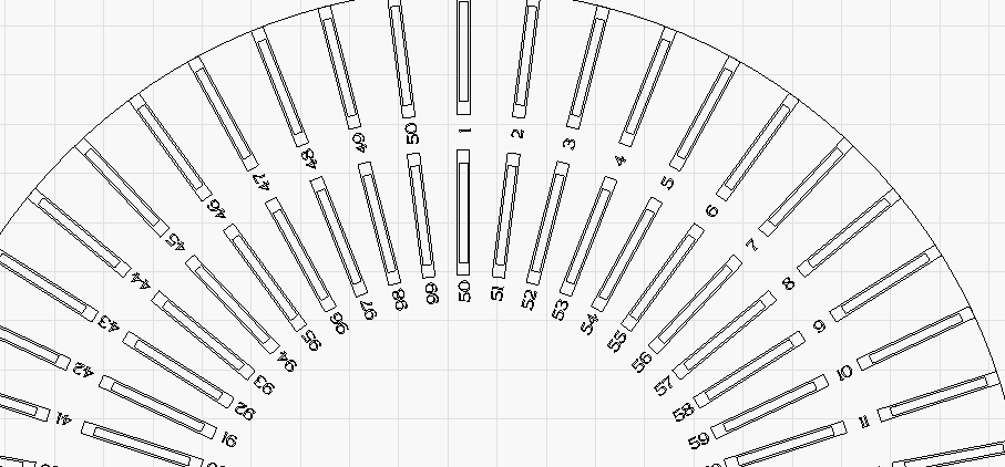

I need the variable to start at 1 and finish at 99, but as it stands, LB is treating all of the variables as if they start at 1 and finish at 50.
I suppose I could do one giant one from 1-99 and then take 50-99, group them and then shrink them down to size.
It doesn’t feel like LB will allow you to continue variable text from one array to another. I did try selecting the second one and starting at 51, but then it just adds it to the first array as well.
I may look at using the csv setting too, which may help here.
