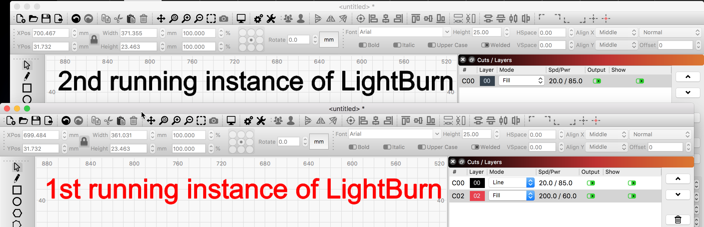

I guess this is a good problem to have, but we run three machines at once, and usually use 1-2 machines to run them. Lightburn doesnt seem to have a good method of managing multiple cut files at the same time, like a multi tab or multiple windows option. The best I have been able to come up with is to start job and then save that file, and open up the next job and start it. Would be ideal to have something like tabs or windows I could switch between in order to keep three projects open at once. Being limited to one project active at a time is a bit frustrating when working with three machines.
This is on OS X, I have a feeling on windows I could have three instances of the same LightBurn open, if there is a way to do that on Mac that could work too.
OSX prevents double-launch of an app by default but you can override this by having more that one copy of LightBurn and name the copy differently (my example - LightBurn.app and LightBurn 2.app).

I should mention that this is a workaround at this point and we have not fully tested all scenarios and ramifications when running multiple instances of LightBurn at one time. Everything should work, but I’d do my own bit of testing to fully understand this flow before I’d use this model in my production environment. :wink:
You can set up a Device Profile for each laser system you want to connect with but can only communicate with one system at a time. If you make changes to the preferences in one instance you will need to close the other instance then relaunch to have it take effect. This is why I warn to take care in using this workaround.
Well, 70 folks have voted for it so far. :wink: Multiple tabs inside of one window · LightBurn
There is a plan for multiple pages in a single document, all sharing the same cut settings, undo buffer, etc.
There is not a plan at this point for multiple tabs for completely distinct projects with their own settings, undo, laser, etc. That will be a fairly dramatic departure for how the app is structured and will take a lot of rework to make it play nice.
