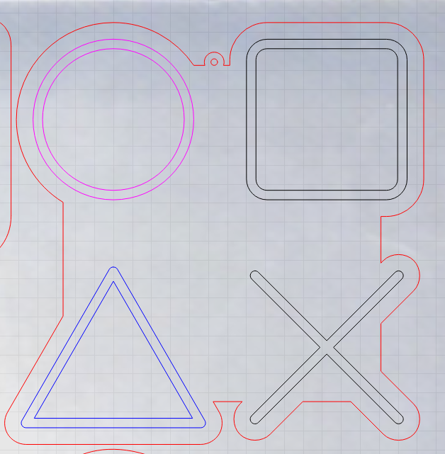

Probably my terminology is wrong. I attached an example of what I meant by a “shape composed of many layers”
Let’s say I have many objects like in the picture attached and after cutting them, I need to go back and redo some of them. Now what I do is send all the other objects to a trash layer, but if I need to retouch anything on those objects I have to reassign the shapes to the layers, and sometimes it’s very tedious especially on very complex SVGs.

I think the closest approximation to this would be toggling the “Output” flag in Cut / Layers window.
That will determine whether or not that layer is considered for output. So disabling output on one would be like muting that whole layer.
That wouldn’t work in my case because it would mute all the shapes at the same time. I guess I’ll keep using the manual “trash layer” method.
