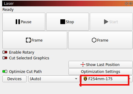

There’s no such thing as a 7070 lens, what they are probably saying is a shorter lens that covers 70x70mm area. Lenses, boxes and where you purchase them use the F designation (flat focus) and are in mm based on focal length. I have F identifier and coverage area when I define a device for each lens.
The advantage of a shorter lens, is a smaller spot (or dot size). If you have the same amount of power in a smaller area, it acts like there has been an increase in power, but it’s just a change in area with the same power across it. The drawback is a much shorter dof, focus is much more critical.
My F254mm has a coverage of 175x175mm, spot size of 31 microns (0.031mm), dof of 4.7mm… Conversely the F100mm, coverage of 70x70mm, spot size of 16 microns, dof of 0.74mm.
I’d suggest a shorter lens, but that gives you much less error in focusing and less area to get your fingers in there…
