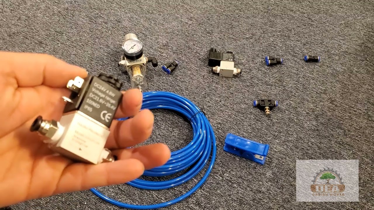

I use the same scheme I believe… assume the solenoids are something like this?
also each one has a diode already installed on it
I removed the ground and even when its selected to be no air assist the air kicks on when i hit send
This is the solenoid that is specified by the video…
All the ground does is to allow the led to illuminate, it’s probably on, until you removed the ground.
There is no diode here, you need to add one.
The two terminals at the top (Red and Blue) are the solenoid connections.
One should go to 24V and the other to the Ruida (either ‘status’ or ‘wind’).
Is that how it’s wired?
Yes there is a diode on mines and yes wired like that 1 power and 1 to wind or standby no ground

EDIT: AT 8:16 THAT IS NOT A DIODE, THAT IS A RESISTOR. I WILL LOOK INTO MAKING ANOTHER VIDEO TO INSTALL A DIODE. THE DIODE SHOULD ONLY HAVE ONE STRIPE ON IT AND WILL BE CONNECTED BETWEEN THE TWO POWER TERMINALS. THE END OF THE DIODE WITH THE STRIPE WILL CONNECT TO THE 24V SIDE, THE OTHER END WILL CONNECT TO THE TERMINAL THAT IS WIRED TO THE WIND OR STATUS TERMINALS ON YOUR CONTROLLER
