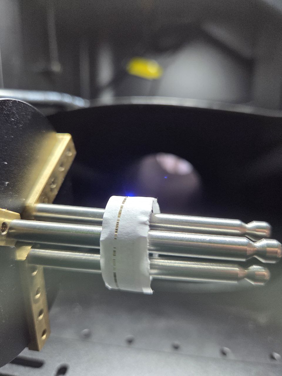

My chuck creates gaps
Hello!
I’ve recently purchased an Omni X UV laser and am having loads of fun with it!
Flat images come out amazing:)
Now I’ve been struggling for hours with the rotary and can’t get it to work properly.

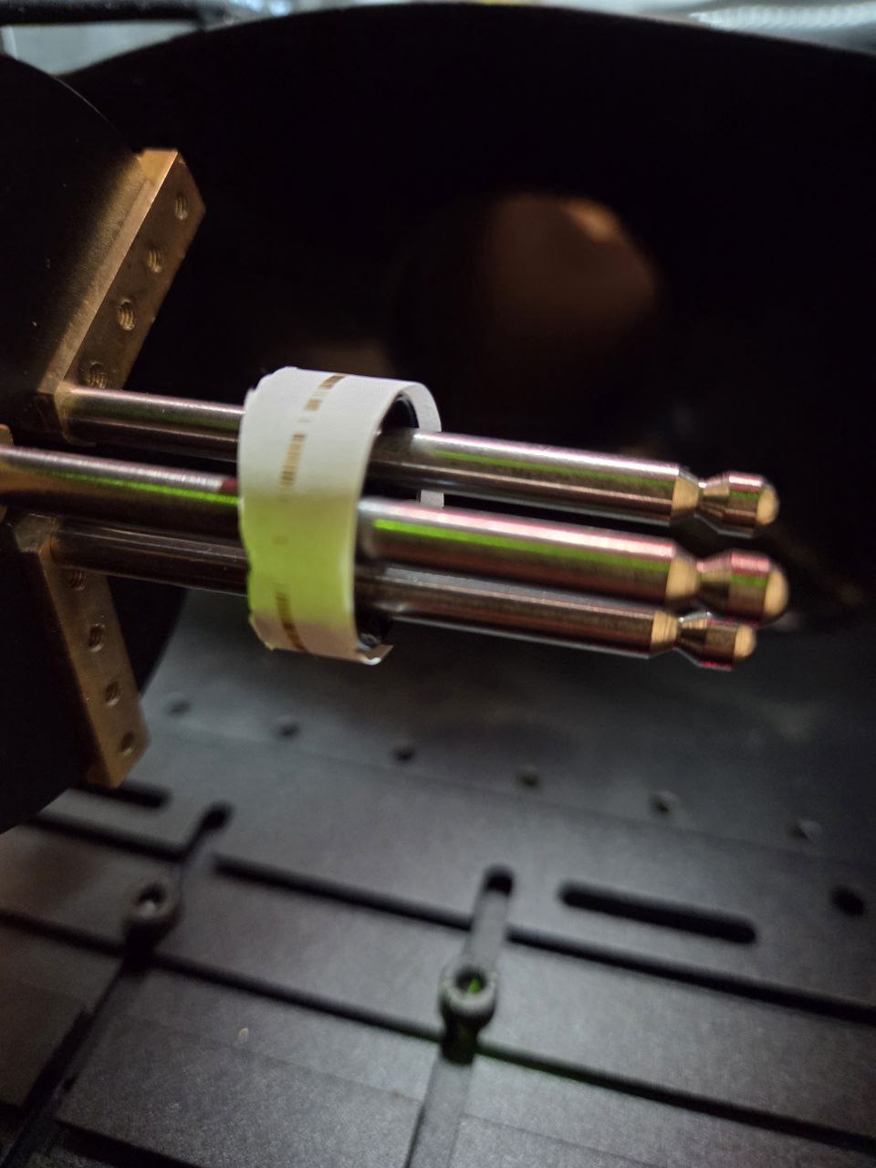

The main problem is that the end result has gaps in it.
A big clue as to where the problem originates seems to be that instead of rotating smoothly it jitters back and forth to do a few lines here and there.

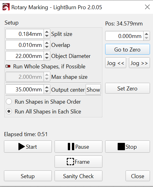

I’ve set up a simple test with a standard box 1mm wide, going around a ring.
Can anyone help point me in the right direction? This is my first experience with a chuck, so I hope it’s a rookie mistake.
Some info that might help:
-The same things happen with an image
-Split size can go as low as 0.023mm, this shows the same behaviour but smaller (harder to see on video)
-Optimization settings Cut in Direction Order/Reduce Travel Moves/Reduce Direction CHanges don’t seem to do anything
Any input is welcome!
Cheers
Erik

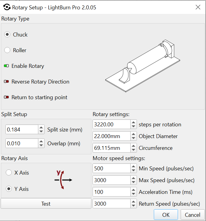

What happens when you hit the “Test” button?
It makes a perfectly smooth circle,
it feels software/settings related
Most likely, the maximum acceleration and speed config settings for the rotary axis (Y? A? U?) are too high by at least a factor of ten.
Cut them down dramatically, see if the situation changes, then tune for best results.
Thank you for your idea, I divided these 4 parameters by a factor 10:
Min/Max speed, Acceleration Time, Return Speed.
There is one huge gap and loads of small ones.
It also overshot by a few degrees/centimeters, so it kept going when it went round once already.
The diameter is 22mm, I drew a line of (22*3.14=)69mm, that checks out..right?
The Acceleration Time seems like the inverse of the acceleration value used in other controllers, so:
  • Reset all the values back the way they were
  • Multiply the Acceleration Time by a factor of ten
If the rotary is not moving smoothly, then it’s not maintaining the correct position, so that’s not surprising.
Happy New Year Ed!
Doing both things you said made a closed circle with no gaps!
Min speed = 50
Max speed = 500
Acceleration time is 10.000 (!)
This made it painfully slow, and the individual lines are still showing, but this is something I can fix with trial and error optimization
Thanks a bunch :green_heart:
I hope your start of 2026 was a good as you made mine :rainbow:
Yay! :grin:
For Fill areas, those can be the same value, because the controller uses the Overscan area to get up to the Max speed.
I was referring to the speeds & accelerations in the Machine Settings for each axis. Those will let you maintain the overall speed for the X axis while limiting the rotary speed / acceleration (which is less critical, because the laser beam is off during those motions). Although you can save / restore those settings in lbset files, you must (remember to) load the appropriate file for each setup.
