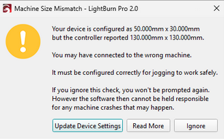

Are you seeing the Machine Size Mismatch similar to this one when connecting the machine?
This is a newer warning that appears if your Device Settings in LightBurn don’t match the firmware settings on your controller.
Selecting “Read More” should bring you to the page linked above with a detailed explanation.
It’s not clear what you did exactly when you “performed a factory reset”. Can you give us more context, and let us know if the docs page helps?
