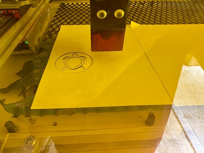

My cut is stopping about half way through
I am working with a home-brew 10w diode laser GRBL controlled laser. I am connected to a MacBook Pro, intel i9 running the latest OSX software and the latest Lightburn.
I use a program called Cutle (https://cuttle.xyz) to generate an SVG that I import into light burn
TurtlePendant
In light burn it renders as I expect it to (a bunch of circles with interior pattern, all cut lines)
I set one cut intensity, home the device (successfully), and play.
The cut looks fine (cuts the first 5 of 12 circles and their contents). Then each time the laser turns off, and the head stops moving. Lightburn still advances the progress bar, but nothing I do seems to have any effect from here on out. How can I troubleshoot this issue?

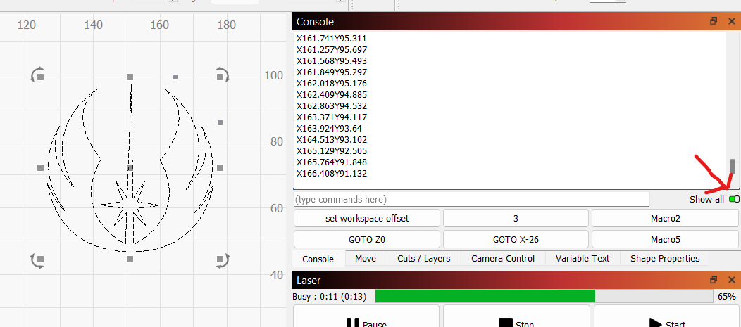

I would start by running it and watching the console. Be sure to turn on Show all.
Actually it’s entirely possible for long durations of cutting at max power to trigger a thermal safety in the diode head. Try running the job with multiple lower power passes, just for kicks, and see if that doesn’t solve the issue. As the OP above noted, reading the console output is where to start as well.
How do I turn on console display? I moved to that tab, but don’t see any output.
Again for thermal, how would I see anything related to temperature?
make sure to click the show all, you should see code happening as you cut
Yeah, I checked that, and nothing was printing…

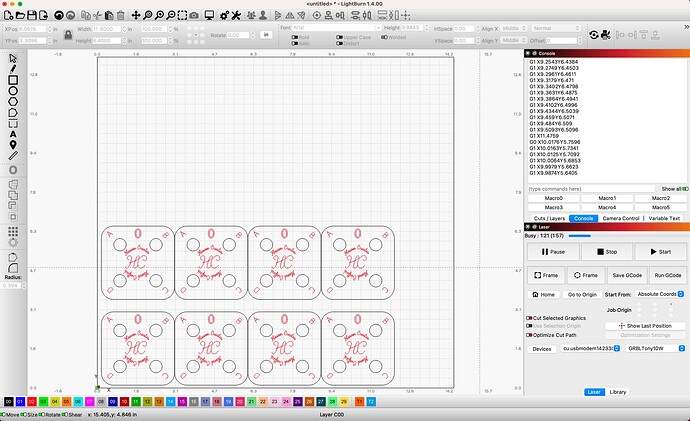

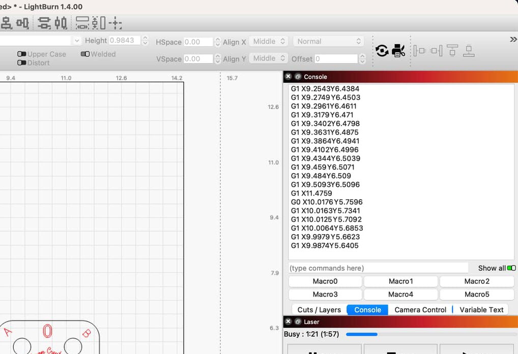

Ok, I decided to try another design, and had the same issue. This time I checked the "show everything BEFORE I started my cut, so I can see the console output.
I see nothing special about the GRBL when it stops. Although this time I was able to hit the “stop” button, and this printed out:
G1 X11.4759
G0 X10.0176Y5.7596
G1 X10.0163Y5.7341
G1 X10.0125Y5.7092
G1 X10.0064Y5.6853
G1 X9.9979Y5.6623
G1 X9.9874Y5.6405
Job halted
Stream completed in 1:27
M5
Grbl 1.1f [‘$’ for help]
G53X-360Y-330F3000:ok
G92X0Y0:ok
ok
Which was different to last time.

I took the SVG file I was having issues with and brought it into Inkscape. I then exported from there.
the laser stoped but much sooner than it had previously, so I don’t think it is the individual file, or a temperature issue.
