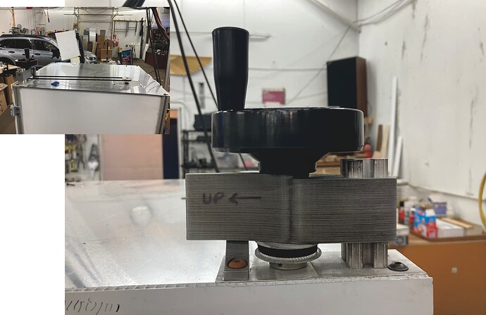

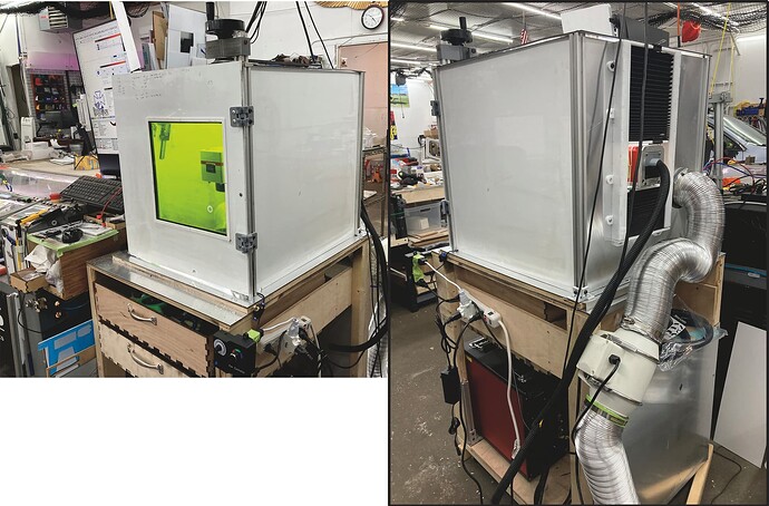

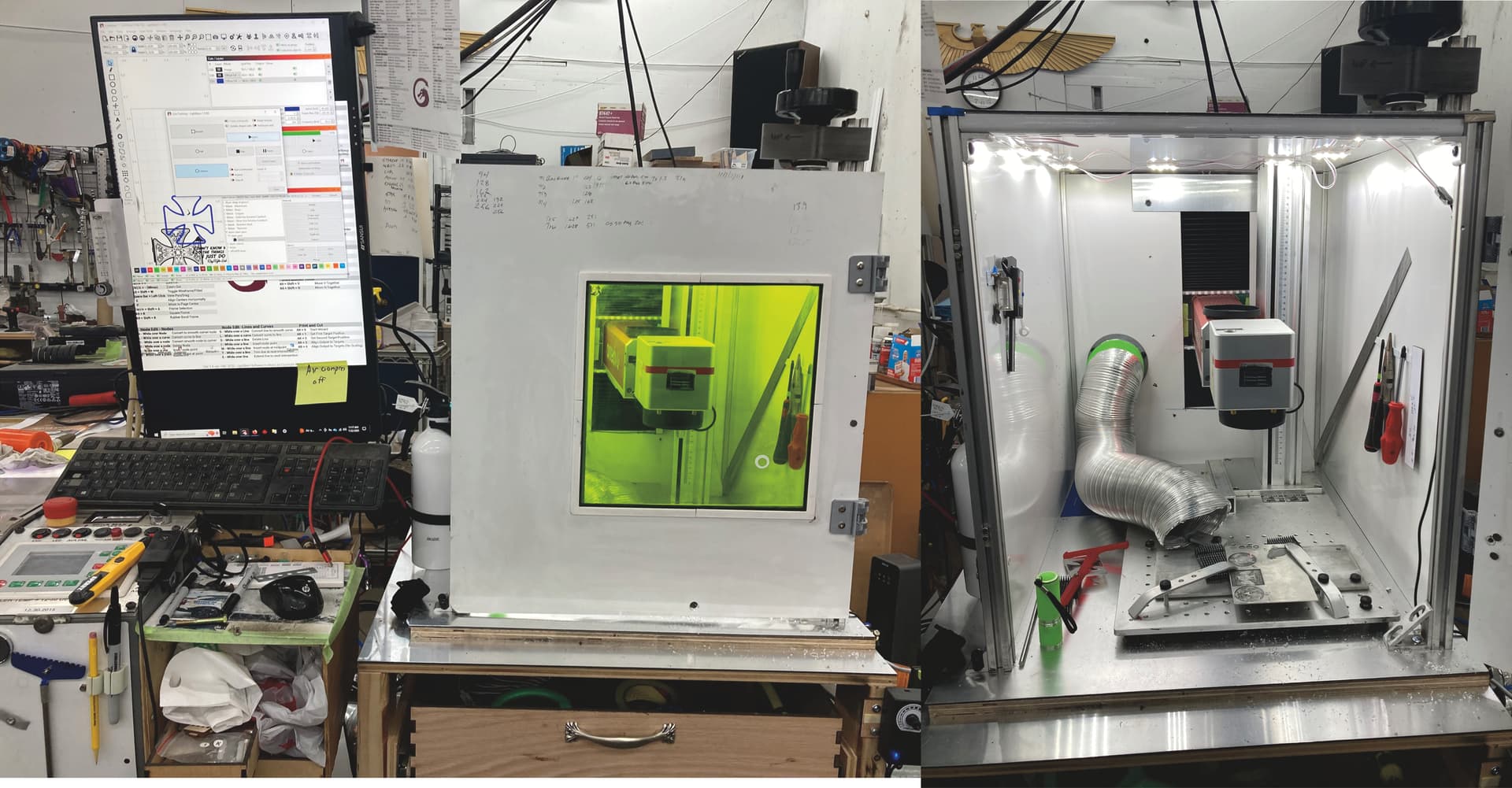

I have finally gotten to a point that I am comfortable enough to take some picts after the great fire of last? month. It is constructed of .25 Alum composite material [ACM] which is used for signboard in our shop now days- started with .5" MDO [medium density overlay plywood 30 years ago- this is much better and lighter. The top and bottom layer are alum and the center is either corrugated [which I used] or solid plastic. I cobbled up a GT2 timing belt system to raise/lower the lense. Here are some picts [I hope] and I will answer any questions you may have. Thanks Gene OK- I cannot remember how I did this before- I have long covid and apparently this is one of my confusion days- I will try to figure out how to post my picts, I hope.

Looks like a well made and well thought out enclosure.
Considering that I had no idea what I needed the enclosure to do, I was fortunate to get fairly close to what I needed. And the fire gave me a chance to fix the things that I did not forsee. The framing is 8020 10 series BTW- I am consumer of 8020 and similar extrusions and have built a lot of stuff from it. Gene
