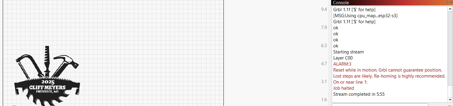

Show your preview screenshot with traverse moves turned on.
Welcome! Thank you for taking a screenshot. It’s appreciated!

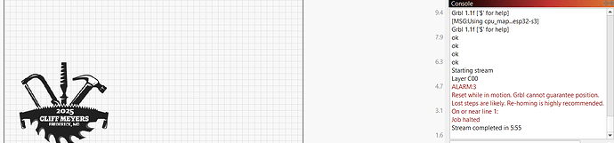

I see Alarm 3 - Reset while in motion.
We often see this when overscan runs out of bounds. Generally this is most likely when engraving images or Filling closed shapes.

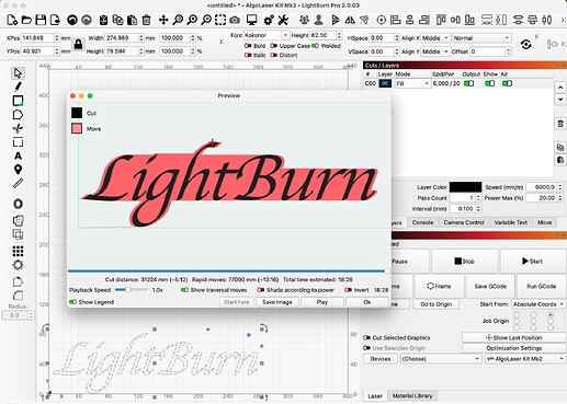

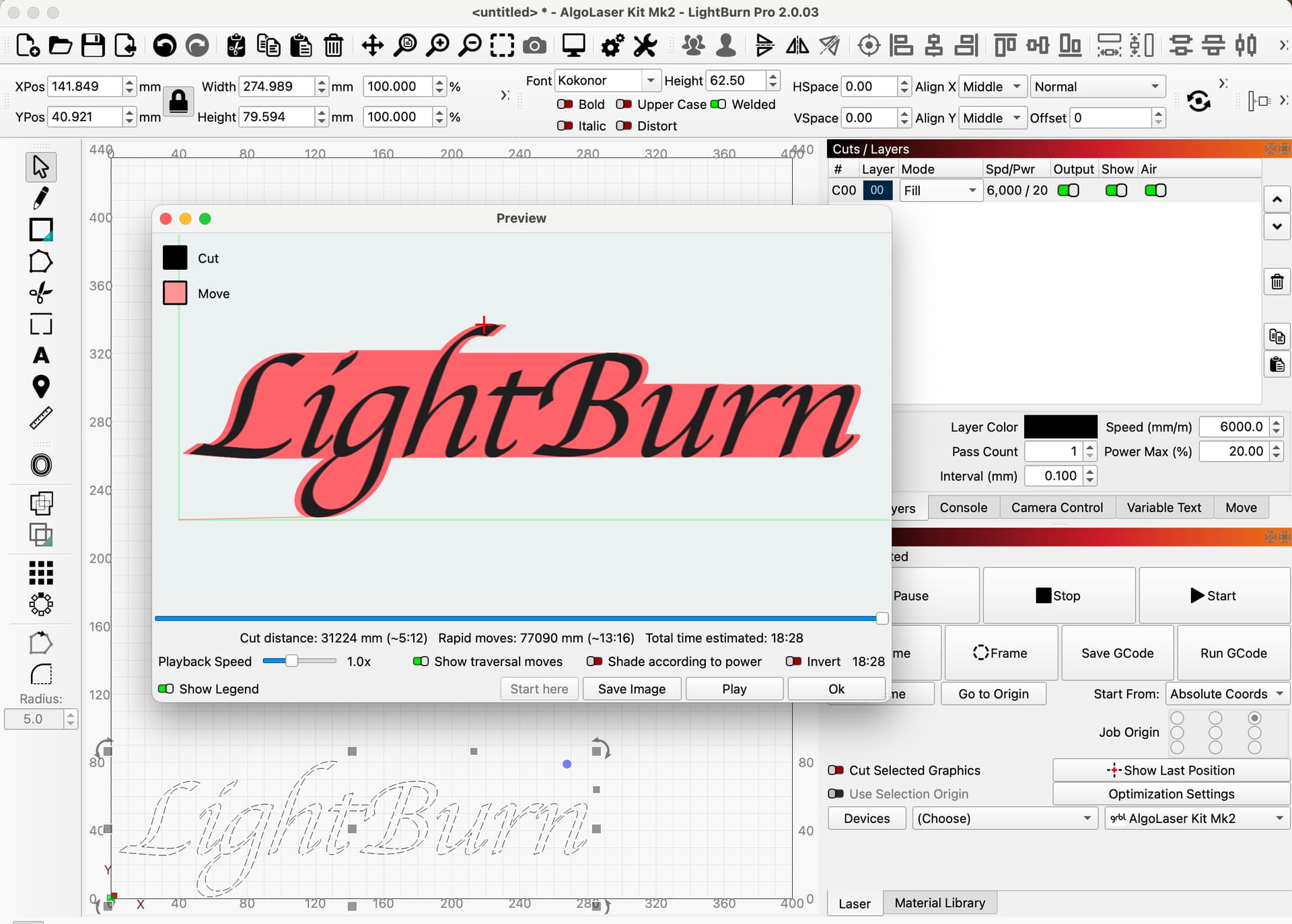

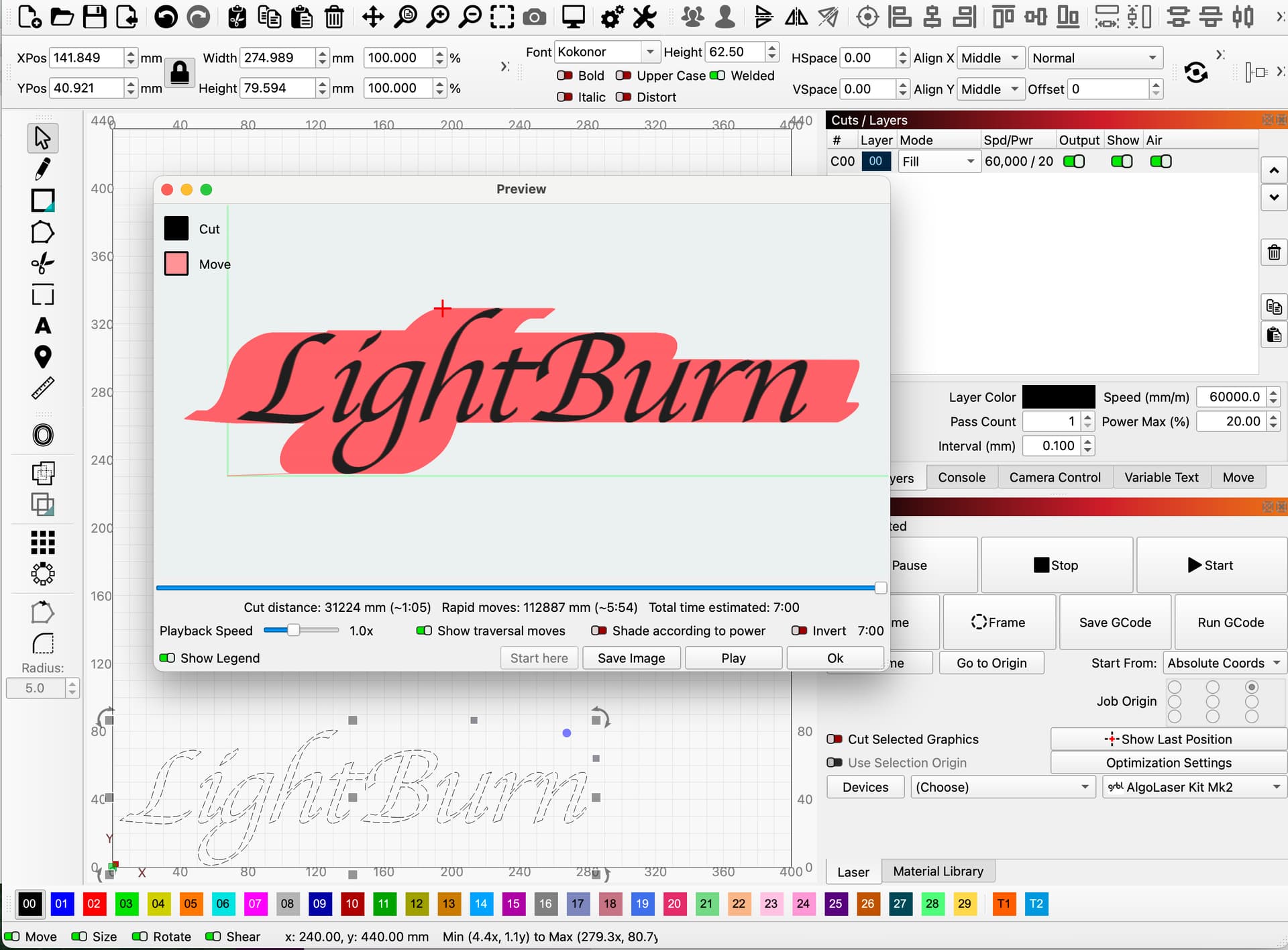

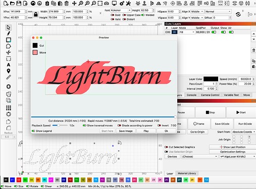

I threw a quick file together and captured two previews. For the second capture, the speed was increased to increase the overscan, which pushes the second attempt out of bounds.
This image shows that there is no overscan outside the boundary.
This image shows the overscan crossing the green boundary line on the left-hand side.
