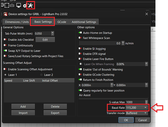

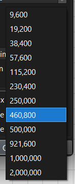

My 70watt 850x800 ikier isnt being recognized by lightburn but laser grbl sees it. Ikier says change the baud rate to 460800 but lightburn doesn’t allow you to see let alone change the baud rate. I need help please!

Sir,

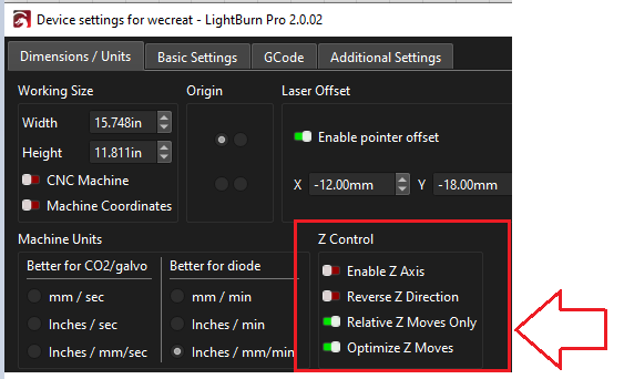

I was able to use an older version of Lightburn that allowed me to change the baud rate. I saved the machine configuration and imported the machine into lightburn and it worked after that. It still wont home z first when homing.
