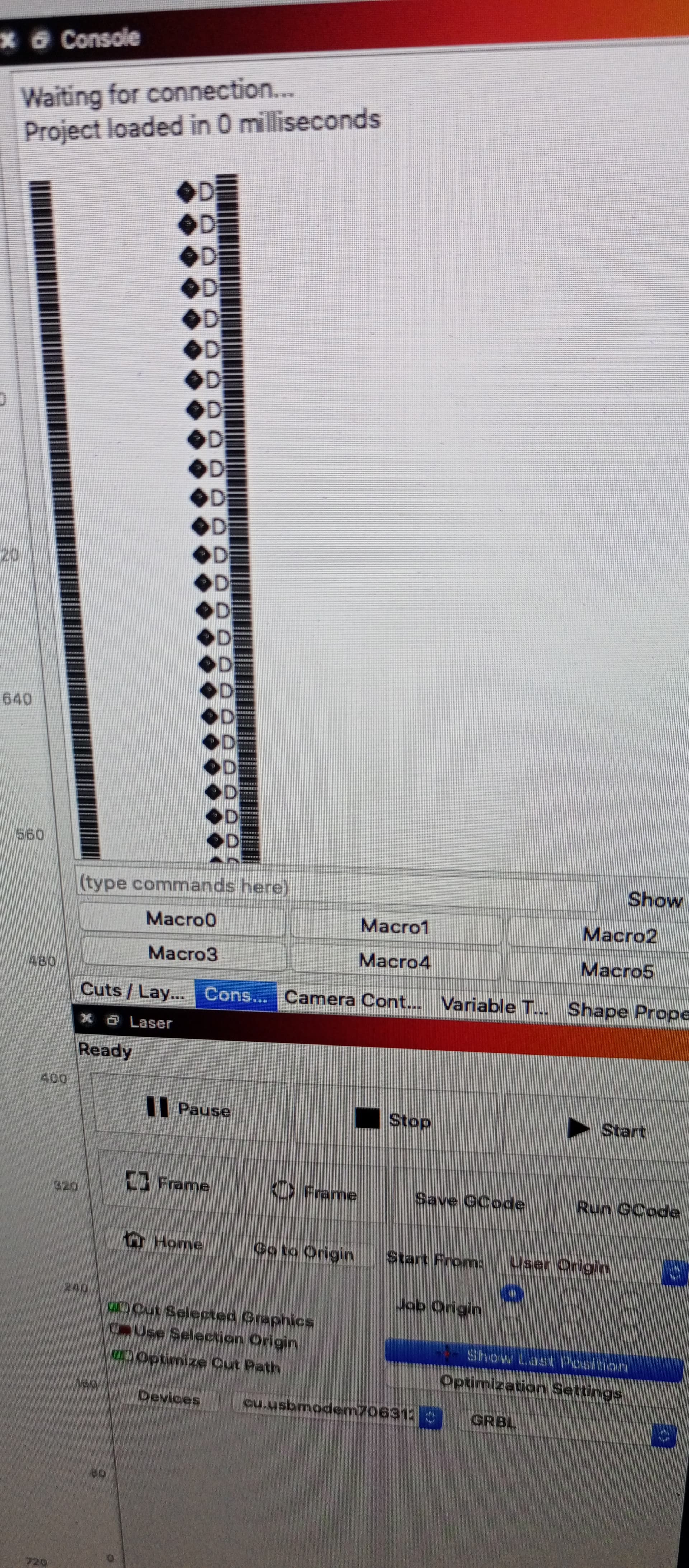

It has been a while, that I didn’t open my sculpfun S9 and today, try to work the connection between my computer and laser don’t work and I see this writing on my Lightburn
Good morning
First, you selected the wrong port. cu.usbmodem is not correct. Check for cu.usbserial***
Next, the connection might also be not stable, in that case, change the USB cable.
Please click this button to expand the available port options and send a revised pic.
It really looks like LightBurn is attempting to talk to another piece of equipment.
If you have installed the CH340 driver, the letters ‘wch’ should appear in one of the serial port options. That would be the one you are looking for. If you see it, please select it and retest communication with your laser.
