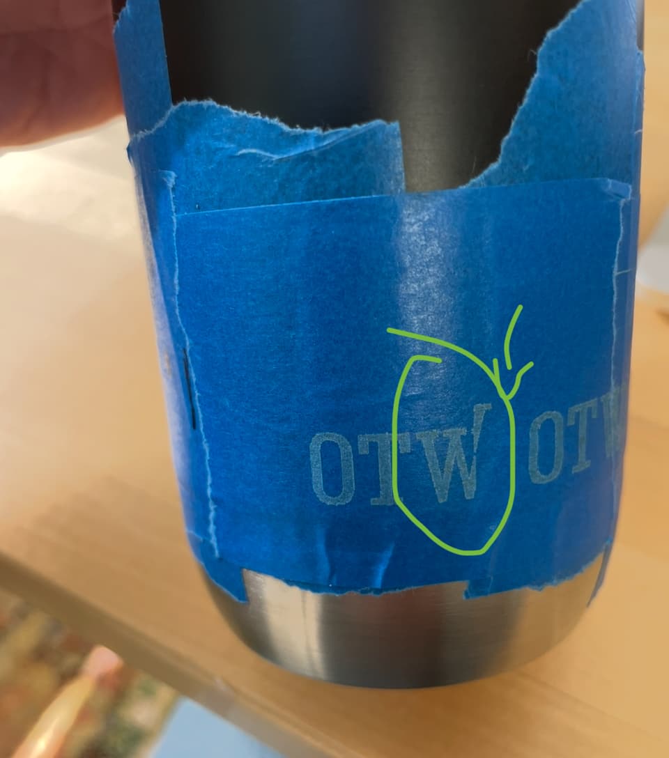

My laser glitches at the last 1/16" of the job
I have an OMTech AF2028 80W laser with a Ruida RDC6442G controller. I am using the 4 wheel rotary to engrave some initials on a tumbler. When the job is about 1/16" from finishing it glitches and messes up the engraving (fortunately it happened when I was testing it out with painters tape).

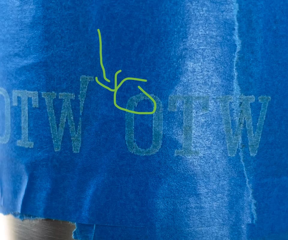

Here are pictures of the two instances it occurred.
The first image is when I had the scan angle set to 0 degrees (ran job from bottom to top) and the second image is when I set the scan angle to 180 degrees (ran job from top to bottom).
I check over the image in Lightburn and previewed the job and everything looked good. I’m not sure what to make of it. I’m pretty new to laser engraving, however, I have engraved 10-12 other tumbler jobs and this is the first time I’ve experienced this issue.
Any advice would be most welcome!
Thanks
Is the machine connected by USB or Ethernet?
That looks very much like a USB communication glitch, rather than a mechanical twitch, because the displacements aren’t permanent.
If you’re using Start to transmit & begin jobs at once, use Send to store them in the controller’s flash file system, then select that file and poke the machine’s Run button. If When a job misbehaves, Run it again: if it misbehaves the same way, then the file has an error due to a communication glitch.
Ethernet connections seem much more resistant to data errors, so switching from USB will be a Good Idea. The doc covers most of the territory:
This extensive discussion describes a DHCP gotcha in grisly detail:
Are you rotating the mug and scanning from top to bottom with each pass? It looks like the fill is going around the mug, meaning you’re not scanning with the X axes as is the norm.
Usually these are set and the Y axes is used for the rotary. Is this what you’re doing?
Are you scanning like this?
One of the issues with roller rotaries are they have a tendency to slip. On my 6442g, I slow down all the Y acceleration values to single digits. The problem is the mass of the object starting and accelerating may require more traction to the wheels.
Thanks! I’ll try that.
