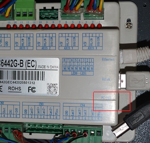

You can try plugging into the controller directly. If you plug it into the side of the machine, there is just a short jumper to another type of usb connector inside on the controller. My usb is unplugged out of the controller.

My laser is in my workshop but doesn’t have internet so can’t use ethernet.
I will try plugging in direct to USB port.
