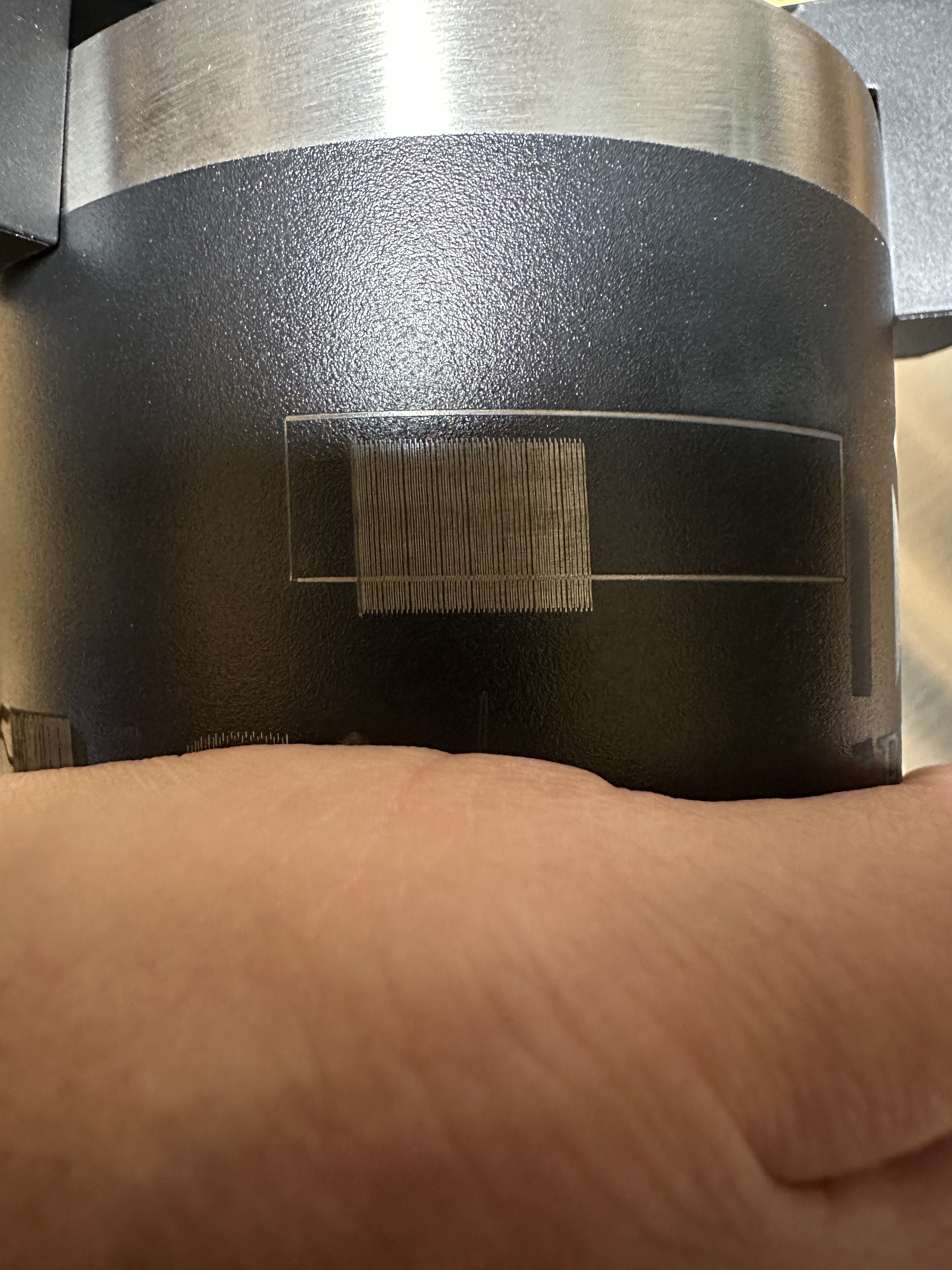

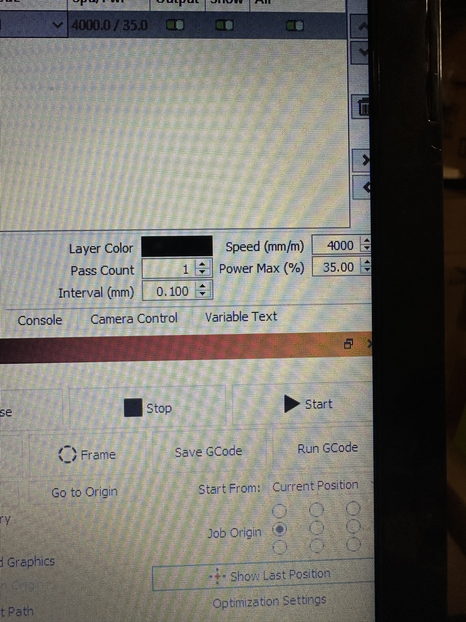

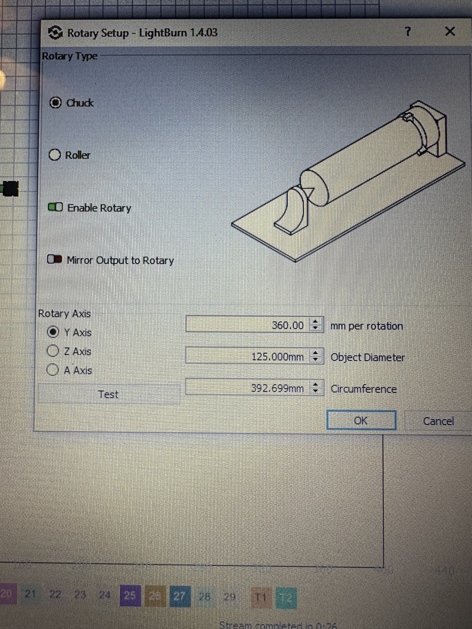

Here are my settings. I’m not sure why it’s not cutting smoothly.
It goes against conventional advice, but I found that engraving at 90 degree angle is better for smooth outcome. I get the same effect as you are showing, but not as pronounced, when engraving at 0 angle. I think there is something out of adjustment on my rotary settings, but I get really good results with my work around.
Thank you I will try this and see if it helps. Thanks!!
