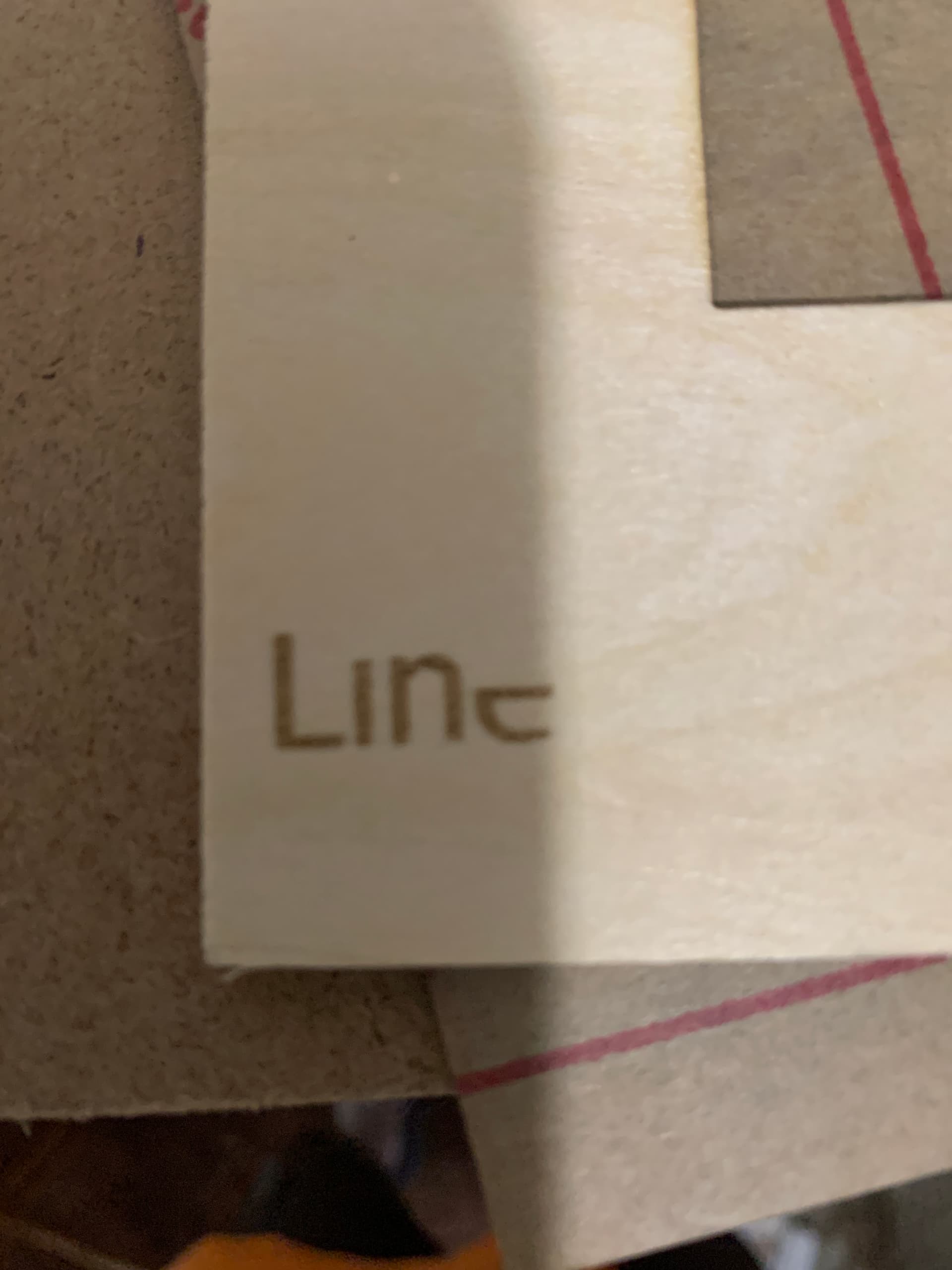

My laser quits after only a few minutes of starting a engrave project
Regardless of the project, my Laser stops engraving after only approx 2 minutes - it cuts just fine.
The issue seems to only be with the engraving.

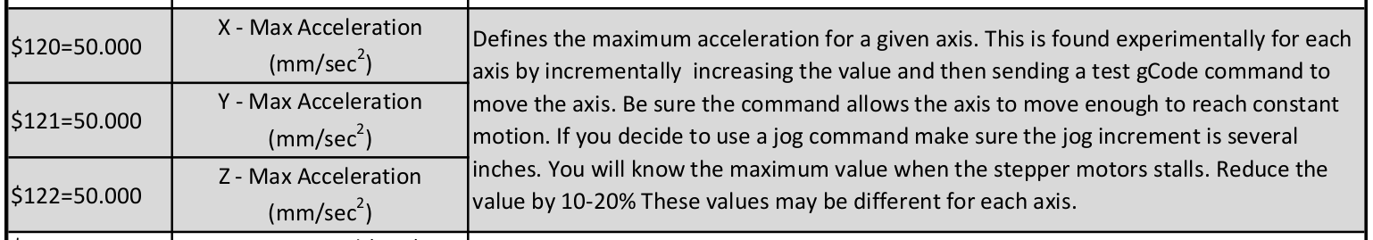

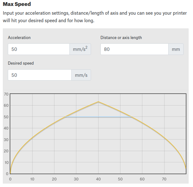

You are only giving it <15mm to get to speed, don’t know if grbl is smart enough to flag this as an error. You’d have to figure out what your acceleration values are to use any of the on-line calculators.
If your speed is set for 50mm/s with an acceleration value of 50mm/s^2, then you need about 25mm to get to speed. These are older machines, so you acceleration values will likely be different. If you use the console and type $$ it should echo all of these variables.
There is a relatively easy way to check, moving the image >25mm away from the edge, as long as it has time to speed up/change directions and slow down. It wouldn’t hurt to make it further away to ensure you’re not too close.
Ok - the machine after stopping is indicating job is done (power light on machine, flashes slowly), no error messages on the console
Using the run time, on my led machine, it estimates it a 2:32. It sounds like it’s doing the job..
What is it doing for those two minutes? Movement? Anything?
Yes, the head does start to engrave, but stops after ~ 2 mins, on this particular design its as shown, and always at this point (on this design)
