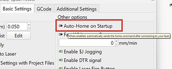

i have a big problem, i have a k40 40w laser which i have upgraded with a mks dlc 32 max,
problem: my laser starts when i turn it on,
does anyone have a wiring diagram or a picture
If it’s moving the gantry towards the endstops, that would be the homing sequence.
This behavior can be turned off in the “Edit > Device Settings”:
If you mean “the laser starts firing”, you need to either invert the pin, add a pull-down resistor, or connect the LPS differently.
Can you post pictures of the controller board and laser power supply, so we can see see how it’s currently wired?
