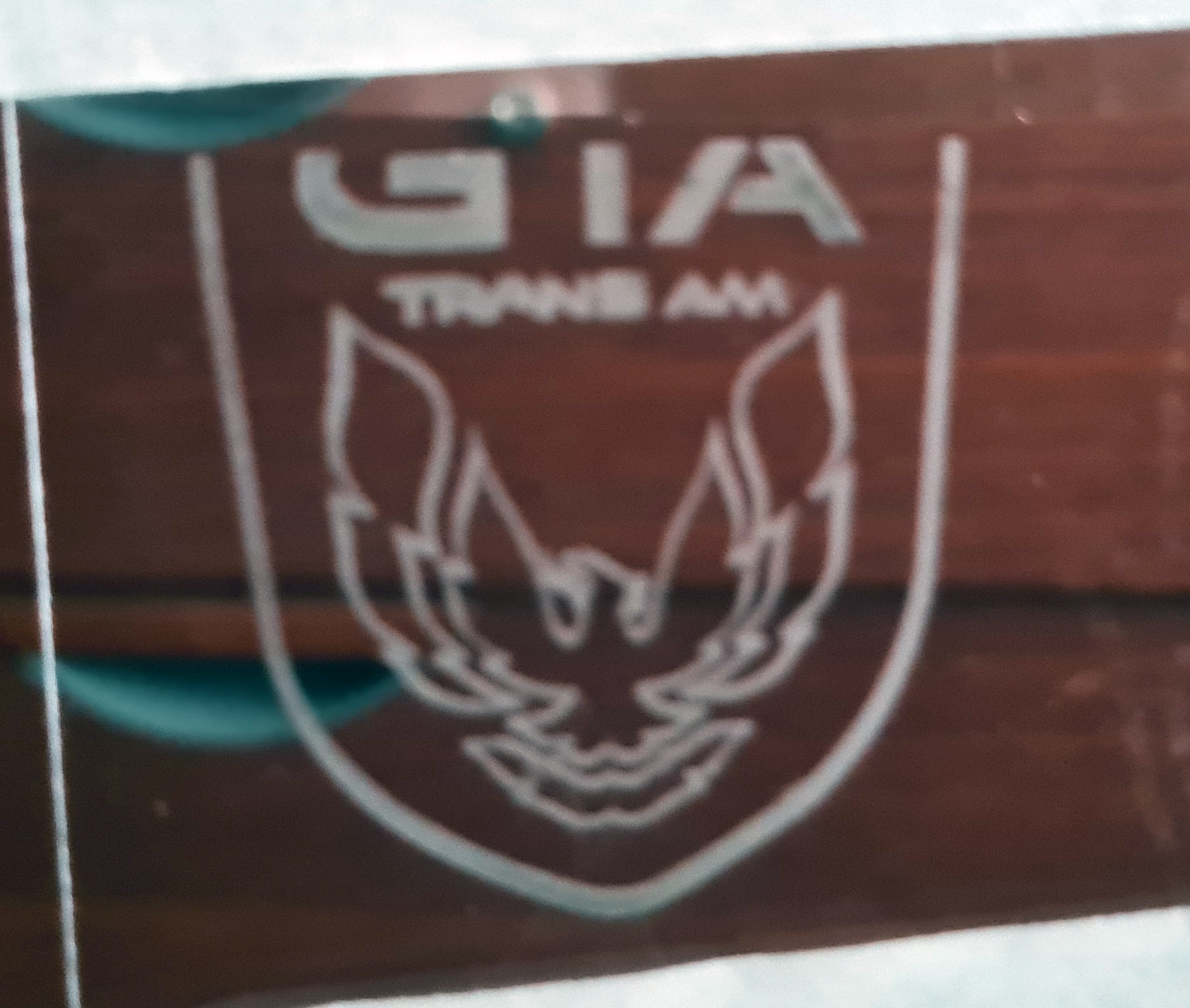

My longer ray5 20 w stop at same place
The laser stop at same place in the picture even if I move to other places and if I change the size on the picture.
I tried only line and then no problem, why does the laser stop when fill?

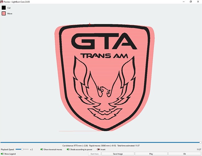

I have the software configured on this machine (PC) to open with the file settings (not the default or last used settings). In the print preview simulation, I didn’t detect anything that would justify the problem.
I even thought it might be something to do with the origin point or final location point, but nothing like that appears in the simulation. (The red lines represent the movement of the laser head).

I tested and stopped at 94 % See picture
He don´t stop if I engrave only line, only with fill.
