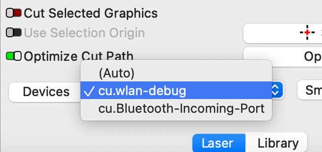

Can you make sure that the correct port is select in the Port field in Laser window? It should be between the Devices button and the name of your laser.
hi! I have two options there… and I´ve tried with both of them and nothing happens

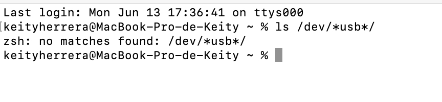

First confirm that you’re getting a proper usb serial port made available by the OS.
in Mac:
ls /dev/*usb*/

Can you take a screenshot of the available ports in LightBurn?
Captura de Pantalla 2022-06-13 a la(s) 5.28.03 p.m.

Where shoul I tape those commands?
Neither of those two options are showing a USB serial port which indicates that the operating system is either not detecting a device or not providing a port.

You would need to open a Terminal window in MacOS.

For this one… says no matches found… and in the system report… USB… doesnt show tha laser

Typo? I’m thinking you want this first version
jack@Kilo:~$ ls /dev/*USB*
/dev/ttyUSB1
Not this...
jack@Kilo:~$ ls /dev/*USB*/
ls: cannot access '/dev/*USB*/': No such file or directory
jack@Kilo:~$
