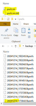

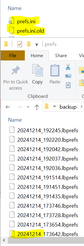

Another way:
Open Prefs folder:
Rename prefs.ini and prefs.ini.old to xxx.error.
Open folder and copy/paste (don´t drag over) an older xxx.lbprefs ( like a month older)file from when it worked to the prefs Directory.
Make 2 copies of xxx.prefs rename to prefs.ini and prefs.ini.old .
Start Lightburn and Load a more recent .prefs file.

Regrettably I had already backed-up the preferences and upon restoring them I didn’t find a history of previous preference files, just the latest … I’ll dig a pair out from another computer’s install and try again what you suggest.

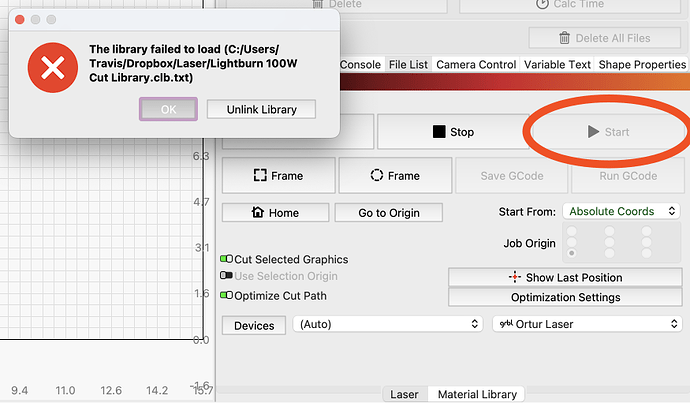

@parsec, what I’m about to describe may be the consequence of bringing Windows install prefs.ini and prefs.ini.old into a Mac but regardless, here goes …

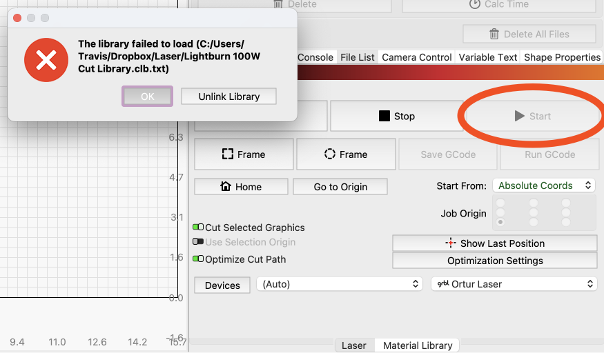

When I first load Lightburn after replacing the prefs files I get this screen with the Start button.

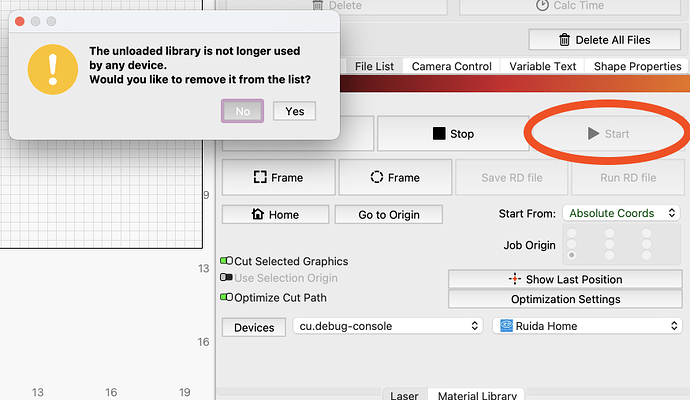

The first time I choose a listed device and then click either OK or Unlink Library I get the following screen.
At this point the Start button disappears.
Any subsequent time I choose the Device
I simply get the Laser window sans Start.

Certainly looks to be referencing a windows path; Can you share that specific prefs.ini file? All the paths in the prefs.ini will be wrong; the following settings would be affected
ArtLibraries
LastCamera
LastDevLibraryPath
LastArtLibraryPath
LastExportPath
LastImportPath
LastProjectPath
MaterialLibraries
I’d assume that blanking each of those in the prefs.ini would be ok/required to un-windows your prefs file. MaterialLibraries and Art Libraries would need to be re-set.
