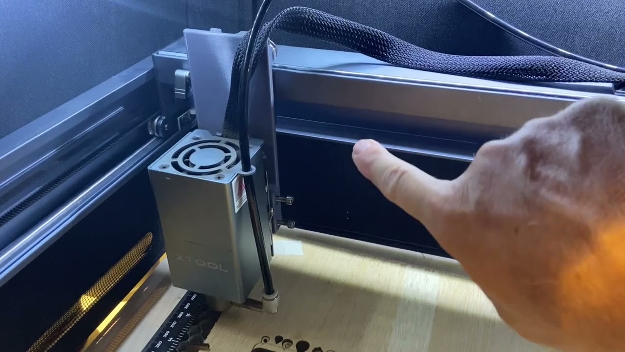

It only looks backwards because I re-routed the wiring per this video on Youtube. I was having issues with the wiring getting bound up on the right side of the bed.
I altered my setup a little from his, though, by electing not to route the cabling across the back of the gantry. I mounted square zip tie holders and ran my cables across the top. I also used one of the mounts to keep my air assist tubing from getting too unruly when hitting the outer extremes of the laser bed.
As it stands, I can manually push the gantry all the way back to the back rail without it hitting any of the wiring or cables. It still, however, will not stay against the rail. When you push it all the way back, it bounces back forward off the rail.
This is part of the HOME issue, I believe, as it accounts for the laser head not stopping exactly on the X-axis when homing. Of course, that might be due to the limit switches, but the result is that sometime it bounces back 2mm and sometimes it bounces back 4mm.

I believe it is the cable on the right of the gantry. Should the gantry go all the way back to the back rail, as in this photo from the setup video?
As I mentioned earlier, from the Youtube video I chose to re-route the cables on the top of the gantry. But at some point the cable has to come down the back of the gantry to be plugged in. Again, going back to the setup video, it gets a little fuzzy when explaining where and how that cable comes down.
In this picture, it appears to be in front of the gantry:
However, in this photo, it appears to be behind the gantry:
So my main issue is that black cable. I believe that is what is causing my bounce back at homing. If I can determine where that is supposed to come down on the gantry that might provide the solution.

Definitely looks to be a cable routing issue. I had the problem when I first assembled mine and immediately rerouted the cabling like this;
I’ve had zero issues with repeatability. While using the little stick on zip tie holders would be better, I didn’t have any, nor did I feel like ordering any, so I just used the existing holes.
I like how you have routed the cables outside away from the bed. Unfortunately, I have the xTool enclosure, so I don’t have the room to route in that direction. It makes sense, though, as that group of cables protruding out the back of gantry can also cause it to bounce against the back rail.
