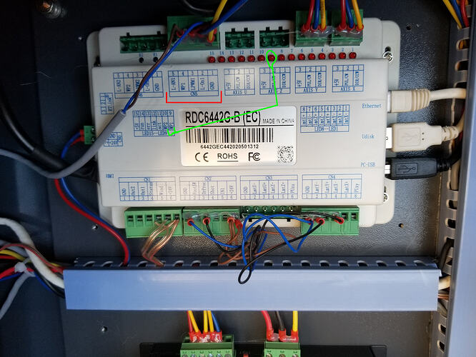

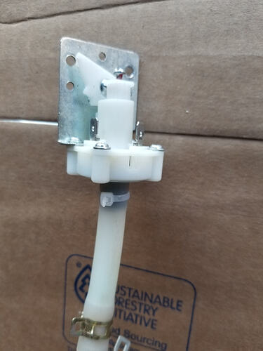

Generally these are wired to the controller. There is a WP (water protection) input on the Ruida that senses a flow sensor. On mine, it was a pressure sensor.
Red line is the CN5 connector with WP1, input from flow sensor.
You can look at led 9, in green to see if the input shows it active.
You can also just measure CN5-4 for active low with a voltmeter.
Make sense?

that white device you show, I am assuming it is the water pressure switch ? which I do not have on my machine. You also show the exact main board that is on my machine RDC6442S-B (EC)
At the present time with my laser powered on the LED situation is listed below:
On my controller LED’s 1-13 are all off
LED 14 is flashing on/off constantly
LED 15 is on steady
looking at the five pin terminal block marked CN5 I have only three wires connected
as follows:
pin 1 GND black wire labeled XG
pin 2 L-0n1 red wire labeled DL
pin 3 LPWM1 no wire attached
pin 4 WP1 no wire attached
pin 5 L-AN1 black wire labeled P1
When I look at LED9-15 data block I note that LED 14 indicates RUN
LED indicates + 5V
where should I put my meter plus and negative leads to check voltage ?
Actually when I measure voltage between pin 5-4 on the CN5 block I get 23.3 volts DC
CN2-3 has an input DrProt which is door protect. Might want to check there.
The Ruida will only display an water protection error is the WP pin remains high.
I’m wondering how they wired you up.
Both of these are outputs, so what you read between them doesn’t have much of a relationship. One is a pwm output, the other is an analog output. The lps will work with either.
All of these are relative to ground, so your minus voltmeter input goes to ground.

Something is telling the Ruida you have a water issue. The wp is an input and is held high internally by the Ruida. This is an open collector input, anything can pull it low. It is active low.. so when it’s running, this pin should be low.
I don’t see how it could complain as that’s the only water protect unless it thinks you have two tubes.

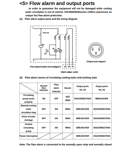

Not a good idea… This helps protect the machine.
You need to wire your chiller up to your laser so it tells the Ruida to halt. If you do this, then you can power up and restart the job where it was interrupted.
What kind of chiller do you have?

My chiller is a CW-3000 Industrial chiller.
I just noticed at the back of the chiller there is an electrical connection with steel 3 pin connector, the wire coming out of the chiller is connected to the laser and is marked water protection. I’ll have to pull out the machine tomorrow to trace that wire to see where exactly it connect to
Yep… this is from my 5000 series, but I’m sure they are the same.
One of these should go to your controller (H3) and the other to ground (H1).
This line could also be wired to the P input of the laser power supply (lps).
