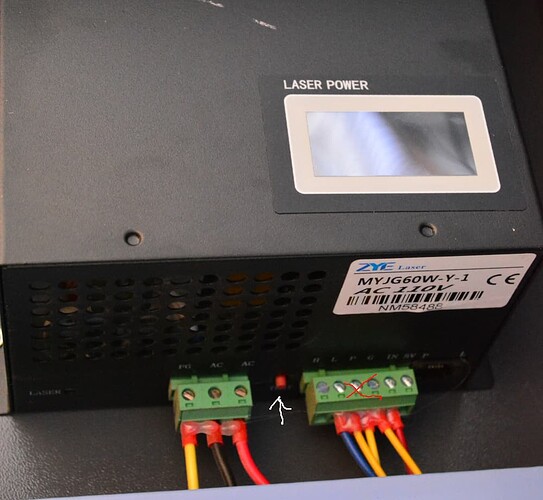

My Omtech laser is not firing I checked the laser tube power supply everything looks good, but I’m still not getting any fire from the laser need help
How did you check it?
Is there power to the co2 tube?, is there “light” in the tube, what does the ammeter show?..
Have you checked your water sensor and door switch?
Feel free to come with a little more info to work with.
This is my LPS… pull the signal connector(s), red X and it should fire with the red button (white arrow) on the lps… Left hand connector is the mains power, that it all that is required.
It will fire at 100% and there is no protection from coolant or any thing else… limit your use of this, it’s for diagnostics only.
