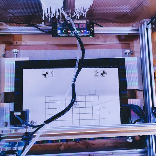

I bought this “5MP USB Camera Module OV5648 Sensor with Auto Focusing for Windows Linux Systems” from E-bay for $32.75 . It seed to be very similar what lightburn sells for a lot less, It has autofocus. It was not soo easy to set but now it works perfectly.
Computer Win10 latest Lightburn for Ruida controller, DSP version.
It has 71 degree so it is not fish-eye makes it more easier to adjust, I can set the material in about 1mm …quite precise…
The mount is only double side tape, I will make a better solution soon myself
So just some info about a good camera solution (ah the USB cable was not long enough of course I needed an extension cord…)

I paid like $44 for an ebay 8mp. I ‘printed’ the mount…
Not the best picture, but…
Yep…very nice. I did not found a really good 8Mpixel version for my 50x40cm 5Mpixel is probably enough. As the mount goes I don’t have a 3D printer I will cut out with laser :slight_smile:
My just made laser cut camera mount in two versions…

How many frames per second is the live feed. I bought a similar camera from Banggood and the live feed was about 1-frames per second (very slow). Over all the camera worked well, but I really like a good live feed to see what the laser is doing and when I set up pieces to be engraved. I replaced it with a USB web cam. It was also a cheaper alternative to the Lightburn cam.
Hmmm good question it seems to be OK for me like 30fps or similar, but anyway the quality of overlay is the most important

I don’t think that 5Mpixel or 1 Mpixel would be the same, that is just impossible. Anyway it was a very cheap cam mush cheaper than Lightburn 's own cam…and about the same… but… whatever if Full HD is enough for you. It was $25 you cannot go wrong with that price…
Let’s keep it cool guys.
Resolution is dependent on your software and display (not necessarily your camera). Many displays are only 1080 and definitely less than 4K, so getting an 8K camera might be overkill which goes to waste in terms of cost. The only advantage of a higher Mpix camera is if you digitally zoom in on details, and depending on your software (LightBurn in this case), that may be derived from the original capture of the software and not using any additional resolution the camera has to offer (can’t say this is the case for LightBurn).
Comparing a 5 Mpix and 1 Mpix camera would show some differences, but anything beyond the capability of the software and display would be of lessening difference.
OK… but with LB you make a picture of your already cutted material and go closer of course and than you can put your tiny cutout stuff into the already cutted plywood and place it on the right spot… you just NEED some resolution for it because you go close really close, you blow up the picture. If you want to be precise you need that 5Mpixel or even more (in this case more IS better) soooo I just don’t understand the argument…sure I want to keep it cool… sorry If I was rude … but you read that crazy post don’t you??? People are strange sometimes… but no problem
