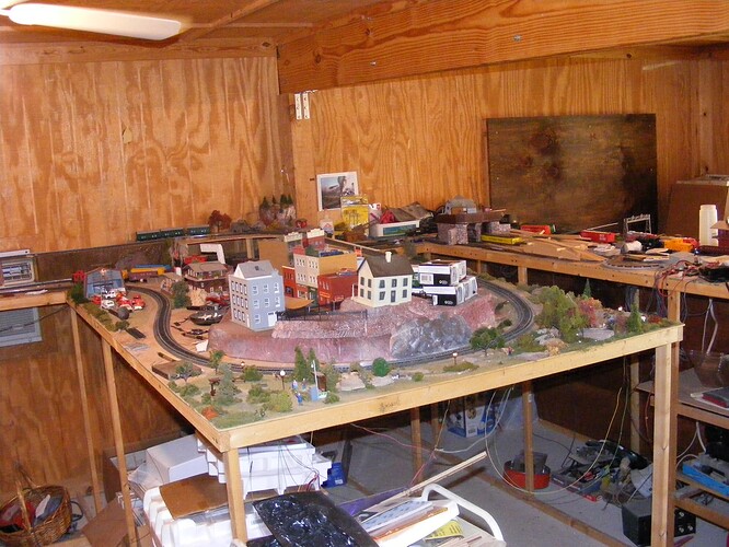

My congrats to you on you fine work. I saw where someone ask if that g-scale.
I missed your answer but I feel that it is g-scale. one of my hobbies is ho-scale
trains. I never built any cars because I was working on layout and scenery.
About 10 years ago my wife said that she wanted the downstairs back. And about the same time two of my grandsons wanted some trains of their own. Funny how my wife and grandsons came up with the same idea at the same time. So I took everything down and hauled it Stillwater, Ok. and set it up in their
garage. I sure do miss playing with mt trains !!!
