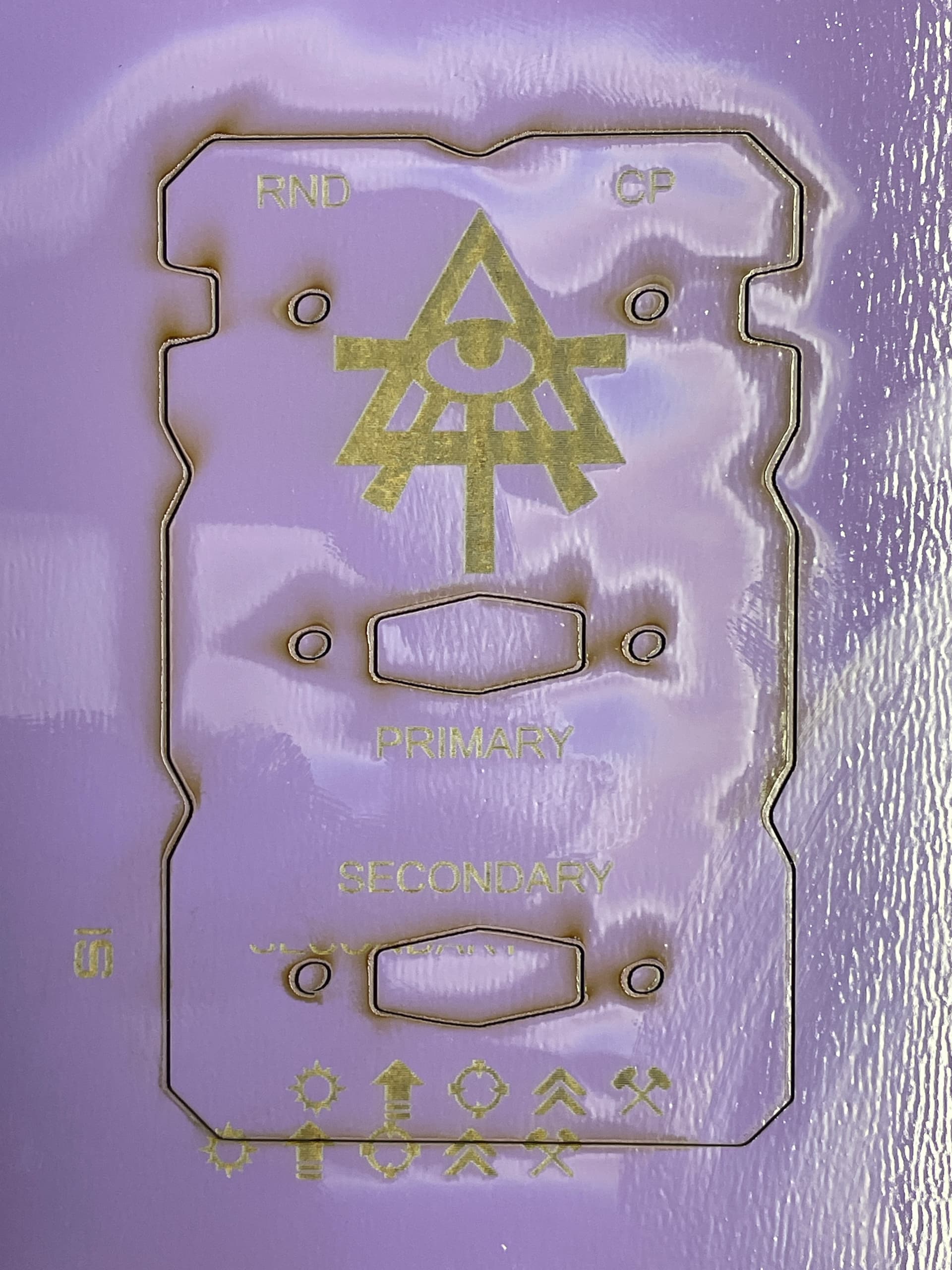

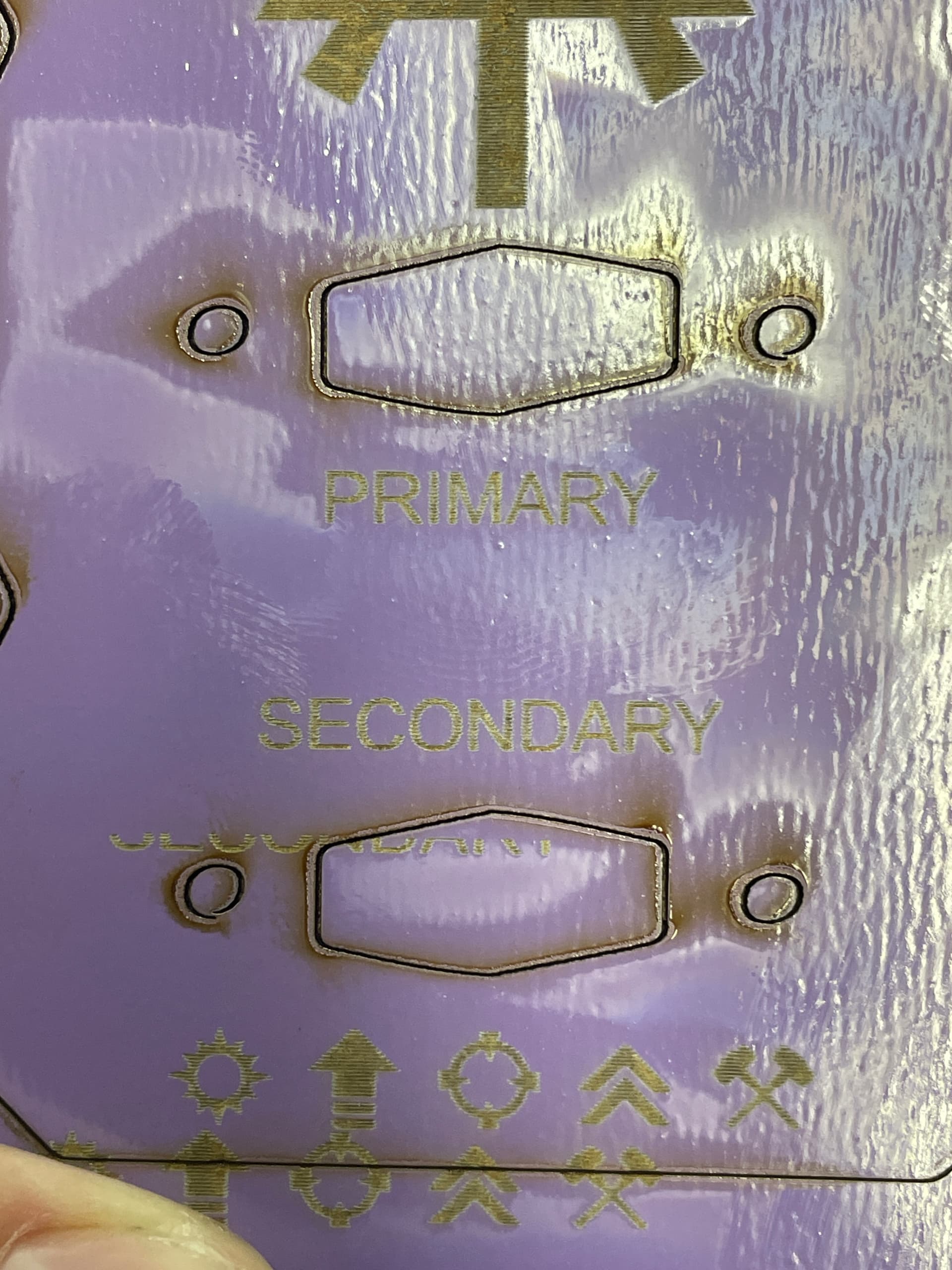

The etchings seem to come out fine, but when it cuts, the shapes get skewed. The circles are not cutting as circles and the hexagons are tilting and are no longer straight.
I am not sure what I am doing wrong. The laser cutter was given to me used and I have not had any experience before with one.

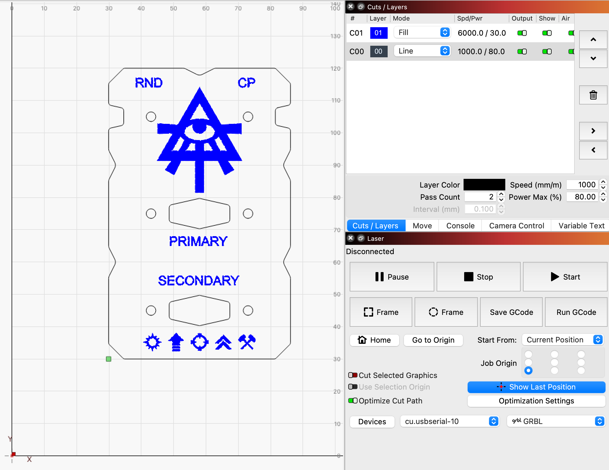

Welcome to the forum! Thanks for sharing a screenshot and a photo of your engraving.
If the preview window doesn’t show the shifted engraving I think you need to do some maintenance to rule out mechanical issues as the cause. This guide is excellent: Guide to mechanical adjustments and maintenance
