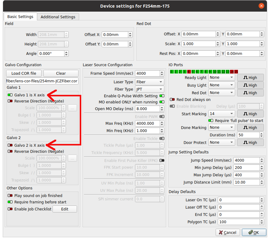

My text is engraving inverted
my text is engraving inverted is there a setting within lightburn to fix

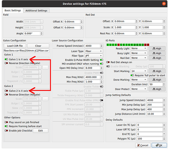

You have your Device Origin set incorrectly. This should help you sort it out:
If you are using your Galvo see this:
Reverse (Negate) the direction for the selected Galvo
Swap which axes is X in the device settings …
Generally this fixes the issue. If you have to, you can use the negate, but I’d suggest you keep it simple.
Thanks everyone problem solved now on to next problem
