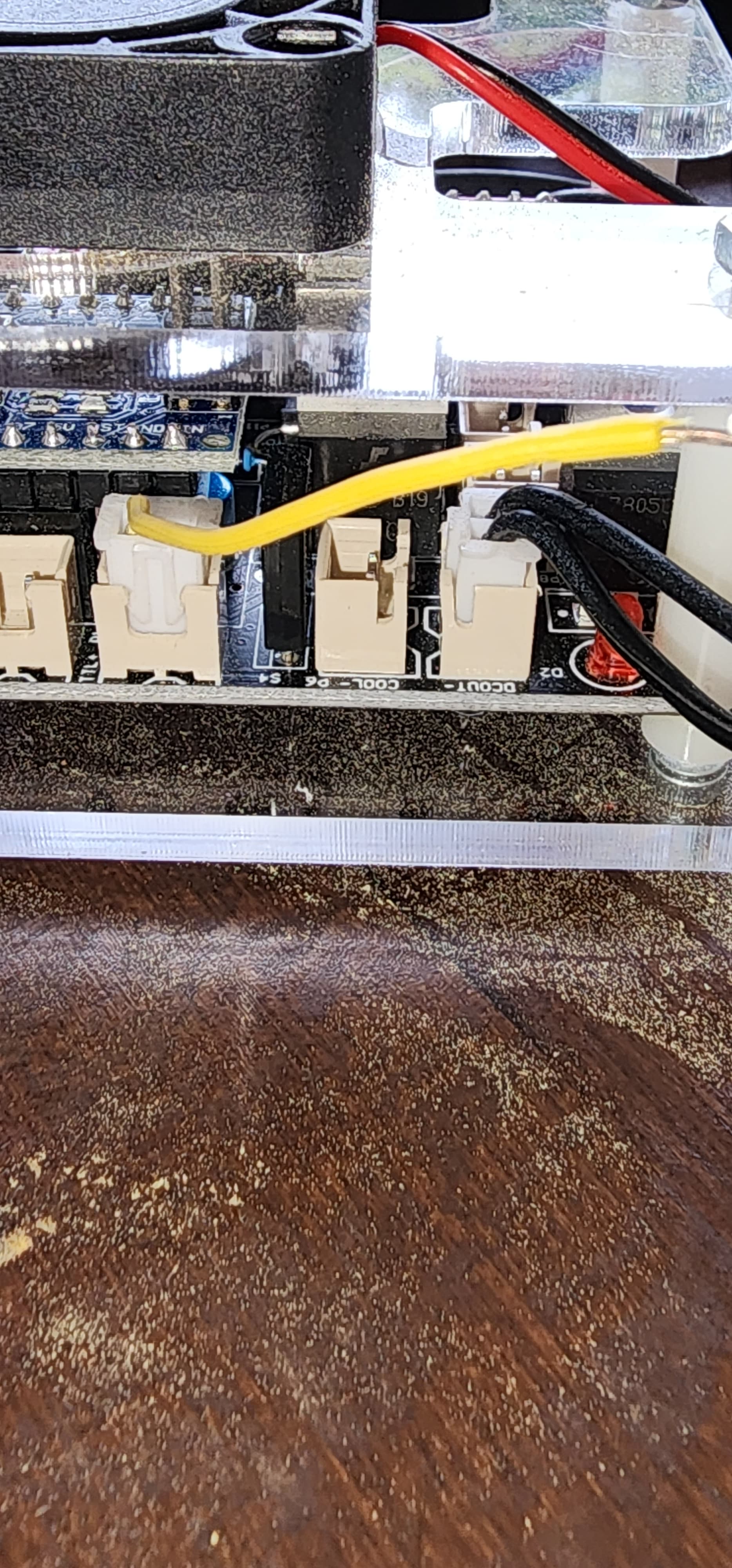

this is the board

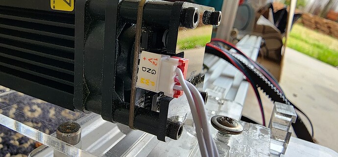

and it is a 15w diode blue laser
Your machine is equipped to handle variable power assuming the firmware is compatible.
However, the way you have it wired now it will not work that way. To be clear, you have a 3-pin connector on the module going to a 2-pin connector on the controller. How is it wired?
For this to work Iād suggest you rewire the controller to the laser module:
I suggest taking 12V and ground from the yellow highlighted connector here. Also, connect TTL and ground from the controller to the PWM and ground pins on the module. So you will need a method of going from two separate 2-pin connectors to a single 3-pin connector.
Separately, if your laser module is indeed 15W output, itās possible that your controller is incapable of supplying the current required for the laser module. In that case, you may want to provide power to the laser module separately. You should be able to run at lower power in any case to test this.
If I understand correctly I think that is how it is wired currently
The yellow wire goes to TTL + and the two black wires go to the laser port that you have highlighted and the correct + & - wires going to the laser module. It had a separate wire going to the pwm pin on the laser module so I added the three wires together in the same molex plug. The strange thing it has been wired like this for years and would burn through any wood in lightburn without any problems. It all started when I updated to grbl 1.1

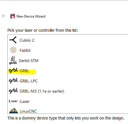

How is your device set up under? Plain GRBL?
Thanks for that I hope he does. And yes version 1.1h grbl
This is what you have it set to in your device.
yes I have that selected. What should I have it set on?
Iām going to assume that even though the color of the wiring is different between the board and the laser module that youāre somehow bridging the wires. Correct me if thatās not the case.
In that case Iāll go back to what I was suggesting earlier.
At the TTL/PWM port on the controller, measure voltage there while youāre running at various power levels in LightBurn. Thatās necessary to know if your controller is modulating power. Depending on the outcome of that test the issue is likely going to be in the firmware yet or in the laser module.
Yes the color of the wire are bridged. Also I checked with my meter on milivolts and the lightburn setting on grbl the voltage at 100% was between .49444 to .53452mv fluctuating. On the grbl 1.1e or earlier settings at 100% it was only 2.449 mv , 50% was 1.18 mv and 20 % was .890mv
