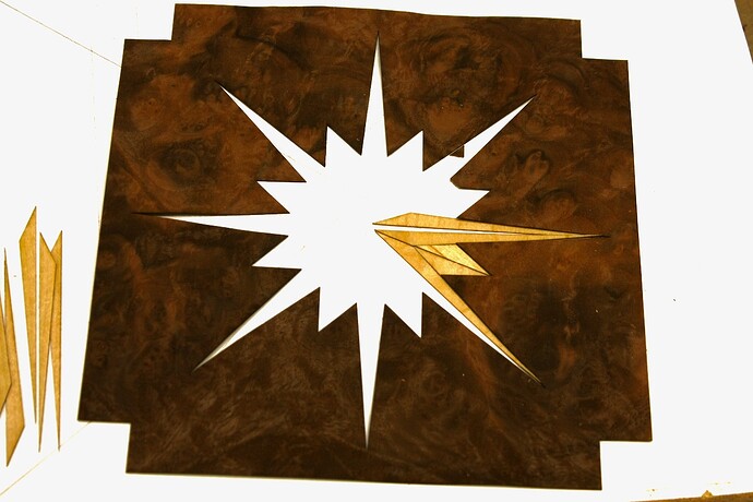

I have to say, I admire your courage. Taking a laser to that beautiful piece of burl would have done me in. How do you even test on a piece like that?
Randy :smiley:
Yes, I’m plagued with that “ability” as well and sometimes have swapped out pieces due to some creature lurking in the background.
My wie sees things all the time in our tile floor which is a rather busy variety of travertine. Plenty of faces and animals. Kind of a Rorschach psych test!
Thanks Mark! :slightly_smiling_face:
I’ll usually test something completely new on paper or thin cardboard, but the burl is just veneer and actually not that expensive. If it was solid, it would be rather unstable (and expensive!)
The only problems are the pointy parts of the cutout. The burl veneer is fragile and these narrow sections are prone to breaking,
Here is a photo of the burl just after cutting out the central shape and preparing to assemble the shapes. It is resting on a white counter so the contrast makes it hard to look at. You can see a small broken-off piece at the 2 o’clock position. Fortunately it is easy enough to position it back when assembling the pattern.
