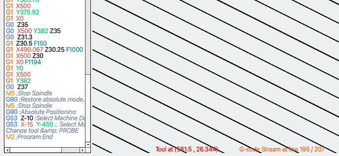

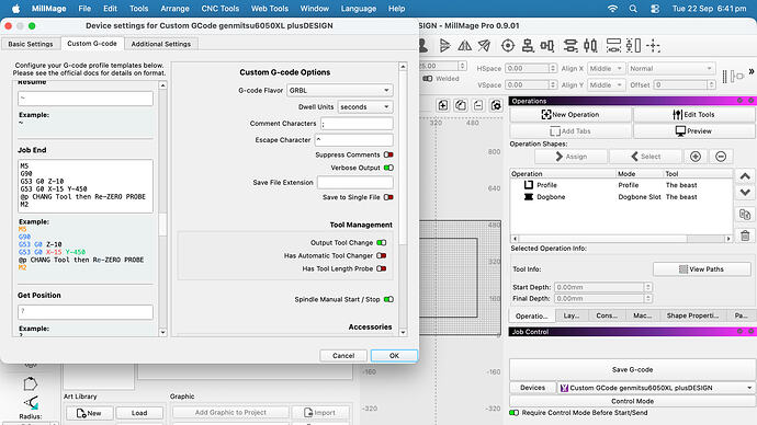

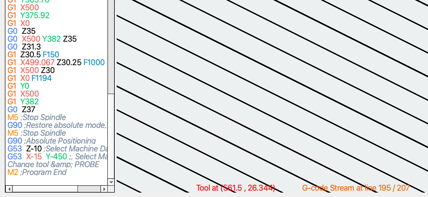

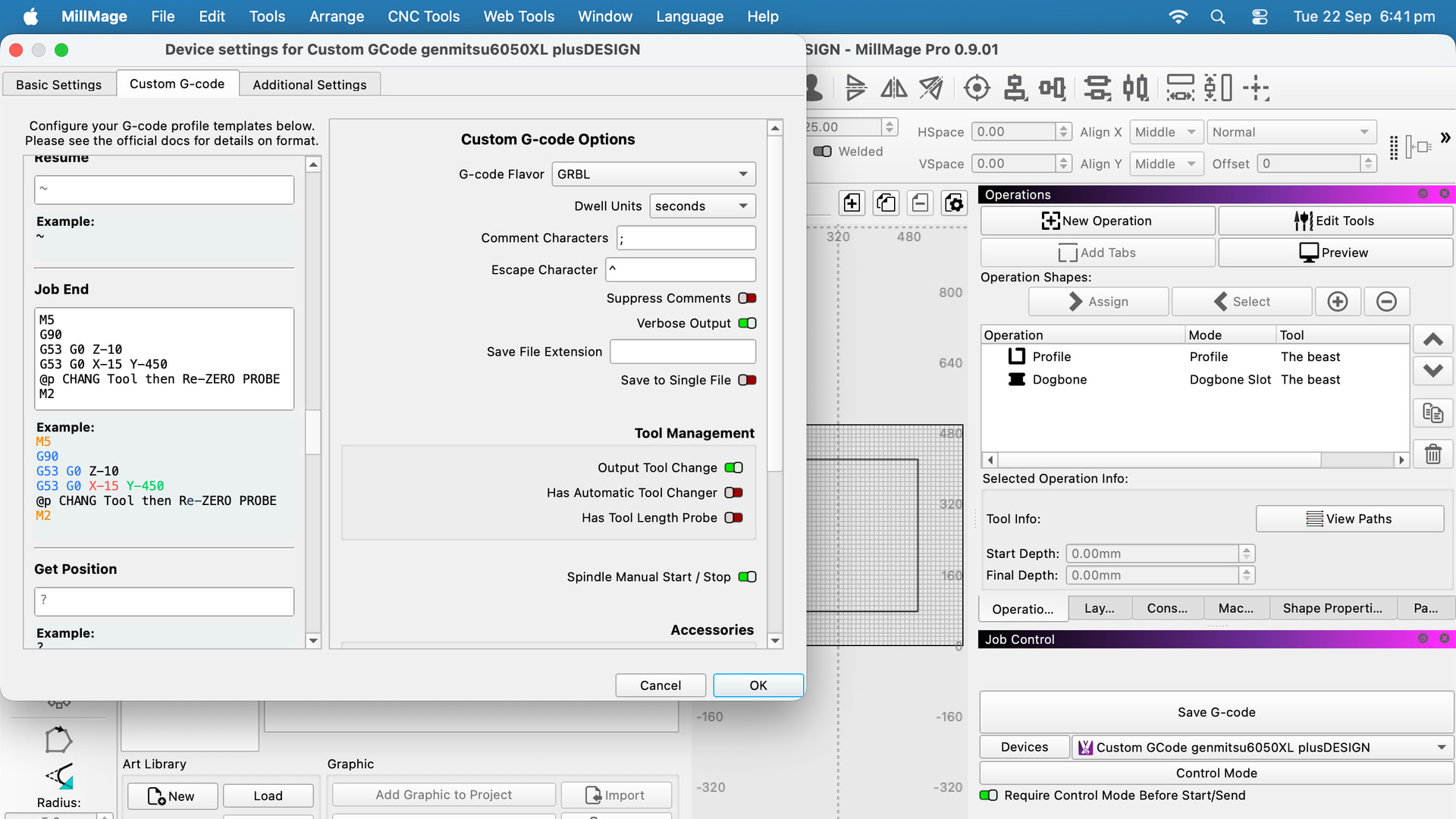

Need a window to give me a reminder to re-zero
hey in
ok so forget the wrong text EG: &amp but the text id like a window to appear as a reminder with the corrected text .I get an error 2 with this if I remove the text no error but im after a reminder window any thoughts
Try the Job Checklist:
is this to re zero before start of job or during tool change, dependent on how you have custom gcodes, tool changer switch on or off MM will auto pop up and tell you what to do next.
dependent on wheer you want it couple options are in
user start script type
$HZ
if before tool change in tool change box i have
$HZ
G0 X200 Y20 F2000 (move to probing location, match first location)
@P (MSG change tool, probe) {tool_name}
if you have tool length probe on , it should auto home Z before probing

so looking at yours if I put ( MSG text text text) do you think that message will com up on screen???
don’t know why it presented in bold?
also im putting this in the custom code on the left at job end! section
should do yes
i dont know if that would give you a pop up as M2 ends job and resets , could be wrong , try it and see what happens
